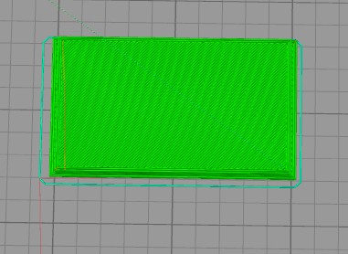

I have 2 stl files that will not print as shown. Can anyone suggest what is wrong?
endcap Print Preview.jpg (27.07 KiB) Viewed 3238 times

Test the stl file. You can use netfabb or makeprintable or any of the on-line repair tools
https://all3dp.com/1/stl-repair-stl-fil ... -3d-model/

I cant see the STL. But I think you have to uncheck "Merge all outlines in to a single solid model" under the Advanced Tab
