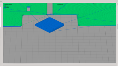

I've a model which I want to print in 2 processes:
1. Extruder 1, stop at Z=1mm
2. Extruder 2, start at Z=1mm
When I turn on the automatic prime pillar in both processes the prime pillar is only printed for process 1. So I created a small box, 2 mm high and added 2 additional processes to print the custom prime pillar with the same start and stop heights, resulting in 4 processes, 2 for the model and 2 for the pillars.
Problem now is that after generation of the print process, first the model is printed and second the prime pillar. How can I change this print order?
In attached image: blue is extruder 1, green is extruder 2. It shows that the 2nd extruder prints the model before the prime pillar.
Thanks for your help!
Mike
