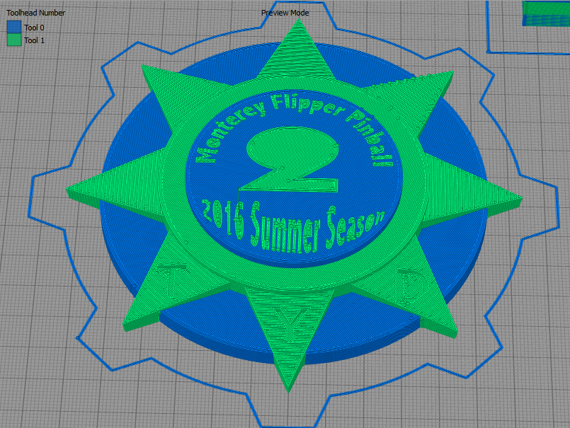

I'm trying to print a bunch of trophies for my pinball league. I designed them in OpenSCAD, and printed the first one:

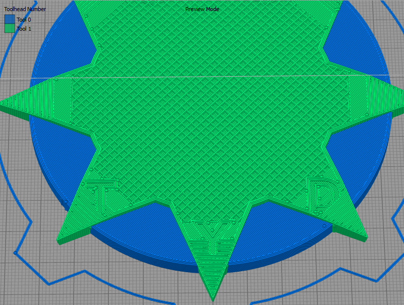

However while I was printing it, I noticed that the infill was unnecessarily complicated, wasting filament, increasing print time, and adding unnecessary filament swapping:

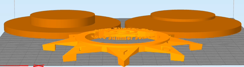

So I made some changes to the design (see base on rear right) so that there wasn't much if any overlap between the two sections:
However that didn't work as expected. Since there's a 3 attachment limit per post, I will continue in the next post...

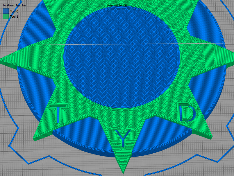

When I slice and check "Merge all outlines into a single model", I get the exact simplified infill I wanted:
4. Merge all outlines into a single model fixes infill but screws up letters.png

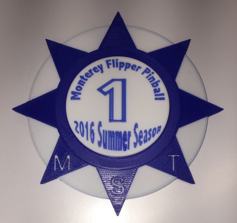

But as you can see above and below, for some reason the slicer adds a layer of green under the letters and in the holes in the text:
If I uncheck "Merge all outlines into a single model", the outside slices well and looks good, but the infill is either:
1) messy (as shown at end of previous message) if I use the solid base model (rear left on image in previous message), or
2) missing, if I use the 2-part base model with the floating ring on top (rear right).
Can anyone show me how to get the outside I want with "clean" infill inside?
