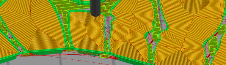

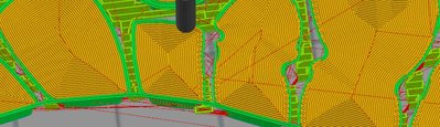

screenshot showing infill pattern is completing a concentric fill - even with setting as rectilinear
Infill pattern is Concentric

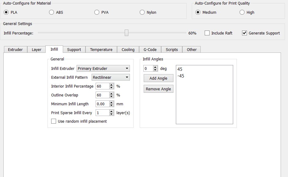

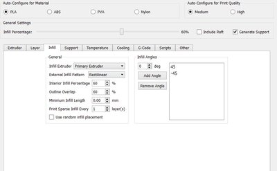

FFF settings with Infill as Rectilinear

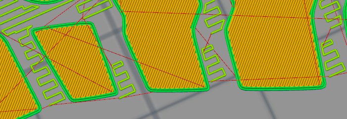

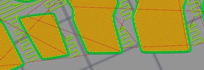

Here is a screenshot for an even more head scratching moment....
The first 14 layers comes up as rectilinear - posted a screenshot. So you feel like it's working - and then you check further layers.
There does not seem to be any settings to CHANGE the infill pattern type by layer - so how is it doing it?
And how do I correct - as need rectilinear for the part strength.....
Print with Rectilinear for First 14 layers
