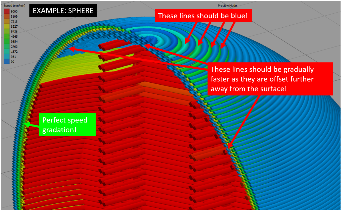

I've attached two images and descriptions which show the current shortcomings of S3D using a cube and sphere as examples. I've used extreme values to better show the speed differences. Solving this is a matter for the S3D developers to create an algorithm that adjusts the speed based on the offset distance from the visible outer surface.
top/bottom solid layers: 4, outlines: 3, default speed: 9000, outline and infill underspeed: 5%.

I feel we can easily reach a consensus. I have no problem with adding detailed control for the user for all print aspects, for example in the "Expert" section. However, the big picture is, if the software is intelligent enough, there is no need for the user to waste time fiddling with every setting.
Let me give an example, instead of slowing the print speed for certain layers to print better overhangs, the software will automatically reduce the print speed for those local areas where the overhangs appear so that those overhangs get printed perfectly without the user having to spend hours trialing to get it right.
To steer the focus slightly back to the original topic, which might have been phrased too simplistic, what I'm proposing is changing the concept of top/bottom + outline shells to a simple "offset" scheme where the speed of filament is determined by the offset distance from the outer visible surface. Of course, on top of this there can be additional settings at the user's discretion to modify the filament properties (speed, width etc), at which offset distance, and location (bottom, top, side, which angle etc).

upsm, I can feel your frustration, however a software with "Simplify" in it's name should be... simple, right? ;) Just kidding. Perhaps S3D in their next release can provide an XML file with a few hundred override settings for advanced users in order to satisfy all target markets.
The main point I'm making is that S3D doesn't speed up the innermost top/bottom solid layers the way it does with the perimeter shells, and offered the"offset" scheme as a way to solve this problem, which I still think is the most robust way forward. Of course, the best way to add extra user control on top of this still needs to be worked out.
