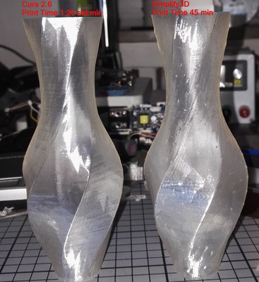

I recently printed some bigger vases in vase mode. I printed them on the Anet A8 with Skynet (Marlin) Firmware (Accel: 400, X/Y Jerk: 20).
But I have blobs on the vase, where there should be none. The gcode doesn't show any retractions (of cause because of the vase mode). Printing speed is 40mm/s and 60% underspeed, so the hole vase is basically printed with 24mm/s.

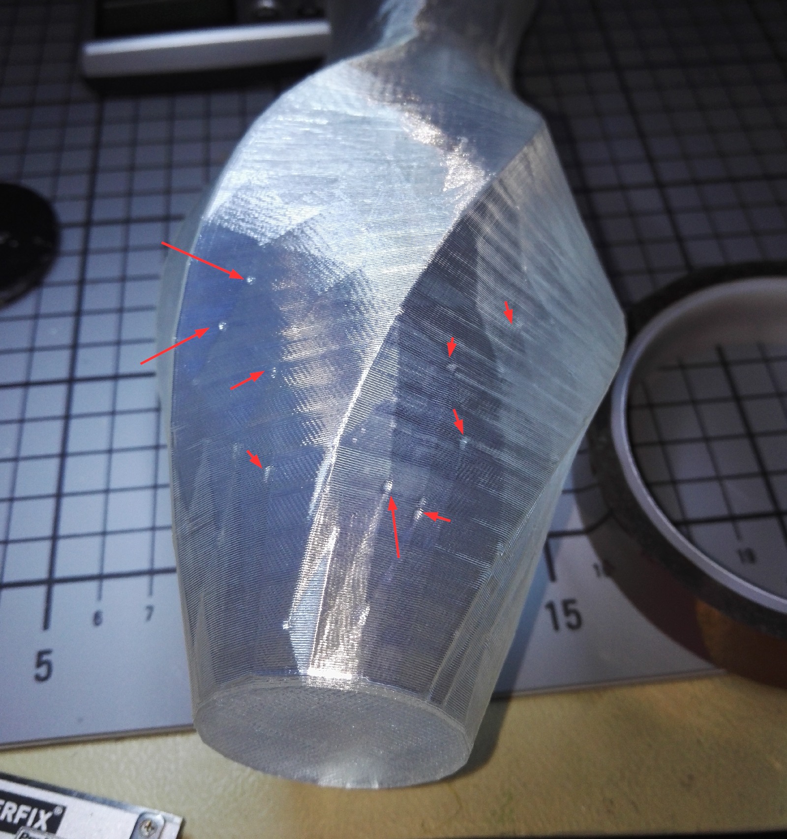

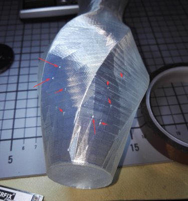

As you might see on the Image the blobs seems to be on positions were a facette changes to an other. So it might be a Acceleration/Jerk problem.
You can here while it is printing some kind of hiccup or a very short pause to think.

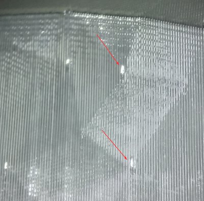

Under the microscope you can definite see that on the blobs is more material:

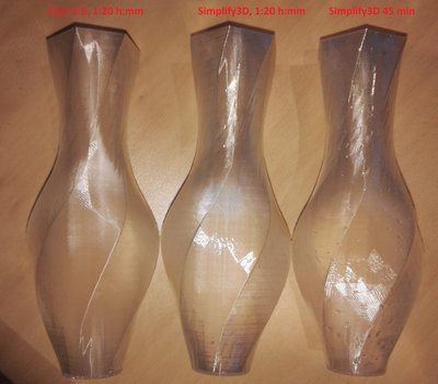

I Just printed the same Vase with Cura and S3D. Cura wins... by far.. almost no blobs.
Since I didn't find any retraction gcodes in the generated files... what could be the problem. Okay Cura printed 50% longer...

wirlybird wrote:Can you tell if the blobs are symmetrical, meaning are they happening at regular intervals or are they just random
More like random, but if they are there, they are on parts where two facettes touches each other.

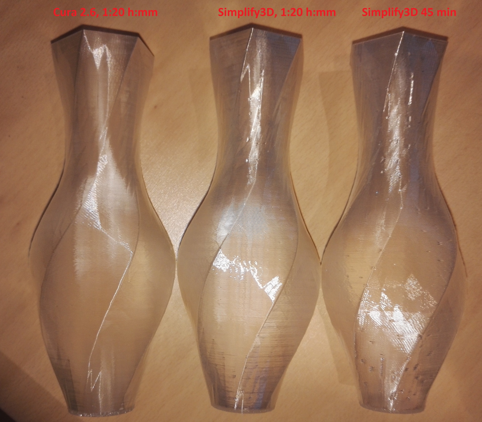

I just printed the Model again in S3D with the same printing time as in Cura.
Still much more blobs than with Cura. And even as it looks like in the image, the slower print with S3D has almost all blobs that the fast one has, they are only not as much visible, but if you turn it in the light you can still the most of them
