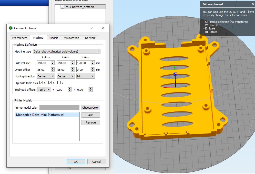

Hello,
I have noticed that when setting up my new delta printer in s3d with a 110mm circular build volume that S3D does not display it accurately. It shows a much larger build plate that allows slicing of objects that are too large.
This does it in the newest and older versions of S3D.
This shows settings with an object that should be too big to print.
Printer Settings with an object that should not fit

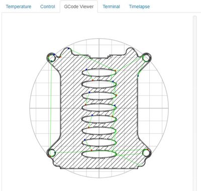

My octoprint gcode viewer showing that it is indeed to large.
GCode view in octopi showing correct area

The X and Y size should be for the square plate that would fit inside your circular bed, not the diameter of the circle. So if you have a 110mm bed, then the X and Y size should be 0.707*110 = 77.77.
So set X and Y to 77.77 and then it will work correctly
