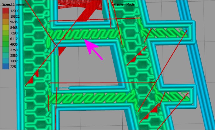

In addition to the giant loops, I noticed that the bottom surface wasn't fully filled in. There are lots of tiny holes, which suggests I'm under extruding. The walls of the bridge areas don't look too bad, it's the interior bottom fill that isn't working. I looked at the preview in S3D, and I think the loops are the result of the zig-zag fill unraveling because the ends never stick to the perimeters:

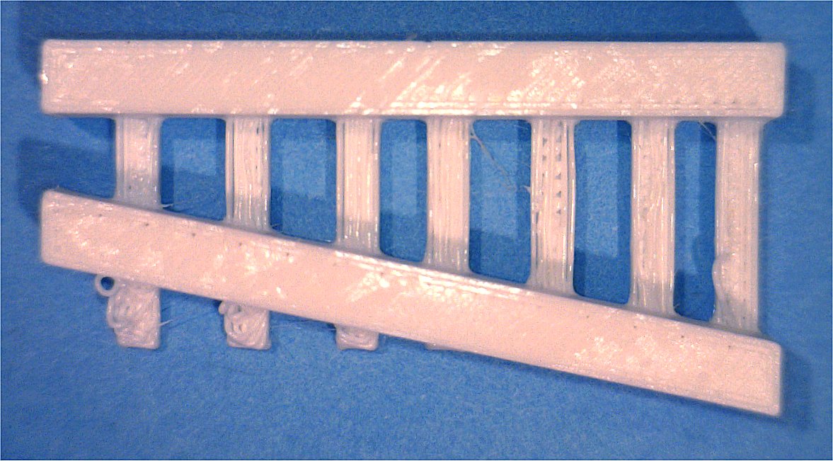

I did some more digging. I'm using version 4.0 of S3D. In the preview mode, I can see that it it properly detecting that it needs to bridge, but it's not automatically aligning the bottom fill with the bridge direction the way it's supposed to. I turned on the "Use fixed bridging angle" setting (using 0 degrees), and the preview shows that the fill will now run lengthwise over the bridge regions. I ran that (also with the extrusion multiplier kicked up to 0.92), and it made a huge difference. This is the underside:
It's still got a lot of small issues. The top side also still shows more signs of under extrusion. You can see where the outer & inner perimeter aren't fused together, especially in the lower right area.
The fill angle was clearly a big issue, but I've got a ways to go before I consider this "solved". I think I'm at a point where I can play a bit with the bridging settings, but I'm not sure which to tweak & in what direction. I also still have some sort of extrusion issue going on.

Also, does anyone know if the "fixed bridging angle" is relative to the bridge direction, or to the X-axis or what? I'm assuming it's relative to the bridge direction, so you can have multiple bridges at odd angles, but I can't find any confirmation of this.
Thanks!
brian442
Posts: 1243
Re: Bridging Issues with PETG
Pretty sure the bridging angle is relative to the x-axis. You can test it on your own though by enabling that option and checking the preview for some different bridges.

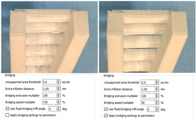

Report from the battlefield:
There seems to be be two theories about bridging with PETG:
1) Go fast to maintain some tension on the material so it won't sag while it cools
2) Go slow, so it will cool in place and not sag.
My first set of parameters used the "fast" approach, because someone else had reported success with it. They also mentioned that good cooling is critical, and even recommended removing the blade guard from the fan to increase air flow.
I wasn't having a lot of luck with going fast, so I cut the speed way down. I also turned on the perimeter bridging option, and backed off a bit on the bridging extrusion multiplier. I don't like changing this many things at once, but it takes close to an hour to print a test run & let it cool to the point where I can pop it loose. In any event, those changes helped significantly. It's still far from perfect, but compared to the rat's nest I had this morning, it's almost usable.
I'm running a test now with all the settings the same, but with the speed at 25%. It's hard to tell, but it looks like there are no loose threads, but at least the longest bridging section has a sag to it. It droops down a little near the anchors, and then goes straight across. The result is that most of the bridge is a fraction of a mm low except near the ends. You can see a little bit of this going on in the left hand print.
The problem I see with going fast is that if you are printing fast enough to keep tension on the thread, it's going to be pulled thin, and you need to add more extrusion multiplier to get it fat enough to fuse to the thread next to it. That wasn't happening with the earlier tests, but I may just have needed to boost my extrusion multiplier more.

Good info. I think you are seeing a weak area for PETG. It hates bridging (poor bridging characteristics) but I think I would have recommended slower, in general PETG likes slower.
I use a lot of PETG so this is great research! Thanks.

Well, I can assure you that going TOO slow with PETG doesn't work. I dropped the bridging speed down to 25%, and things definitely got worse. I'm going to try a few more experiments, and then I need to switch over to PLA for another job. I haven't played much with the bridging extrusion multiplier yet. So far I know that:
Extr Mult = 150%, Speed = 130%: Bad sags on bridges > ~ 1cm, bottom threads aren't fused together
Extr Mult = 120%, Speed = 50%: Sags a little near ends, but no bad sags. Bottom threads still aren't fused together uniformly
Extr Mult = 120%, Speed = 25%: Bad sags on longer bridges. Bottom threads still not fused together well
I think I will try 75% for speed, and 150% for the multiplier.
Given that the side walls (perimeters) of the bridges never looked too bad, and that I'm printing at 100% speed, I was thinking I might also turn off the perimeter bridging option. I suddenly realized that is another clue. My perimeter speed is set at 50%, so that explains why they looked OK.
Independent of the bridging, I've still had to crank up my regular extrusion multiplier to 0.94 to get decent fill on the top & bottom layers. I haven't had a chance to go back to a single wall calibration cube to check the wall width, but I bet it's way over .45 mm.
One very important thing to bear in mind when trying to hone settings is.....NEVER change two parameters at the same time! You'll never be able to figure out which setting causes the changes in the test results.....or you'll assume its changing one that gives results when its actually changing the other that makes the difference!!!
The new feature of bridging being applied to perimeters was added in v4.0.0 to help prevent sagging perimeters. One of your comparison tests in this thread has one test with this feature off...and it looks as if there's sagging perimeters. The accompanying test has this feature on....and other changes as well.....and there is little sagging. I'm guessing your conclusion from that test is that the "other" setting change had the major effect on sagging, but it may be that its the checking of the perimeter setting that has had the effect!
