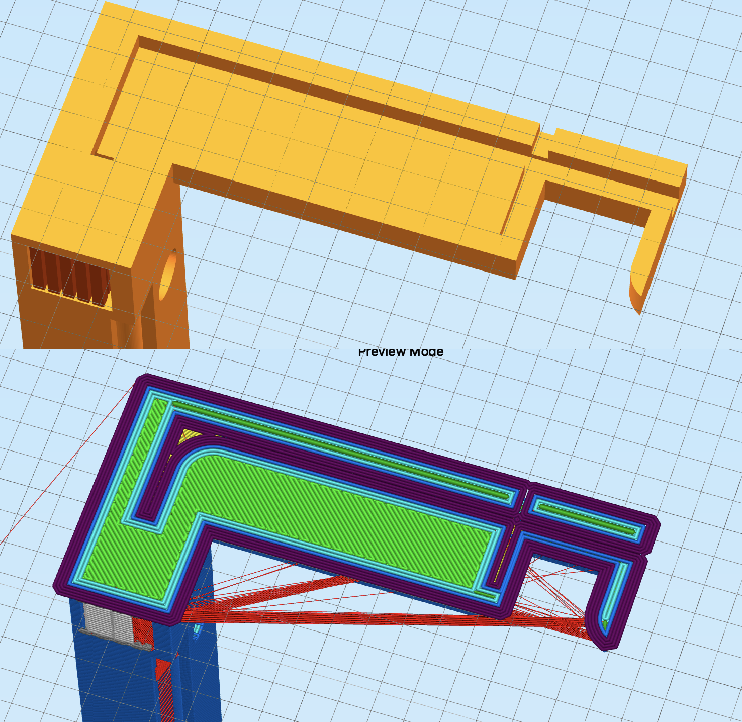

Suggestion: provide a similar feature for zero-offset skirts in which you can select / deselect edges of the .stl model that are in contact with the surface of the bed.
Here's a simple example (attached). The part (viewed from underneath) has channels cut in the bottom: definitely don't want the skirt in there! At the same time the part is sort of long and thin and desperately needs an attached skirt to keep it from warping, particular as it contains a tall tower structure (partially visible).
viewed from underneath bed
