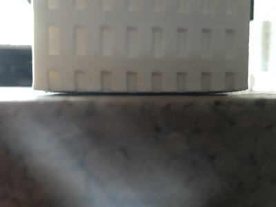

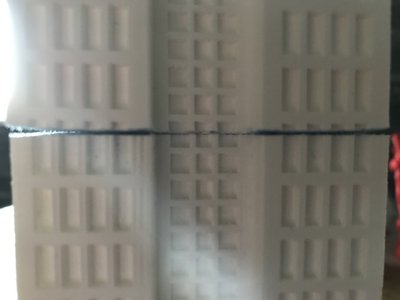

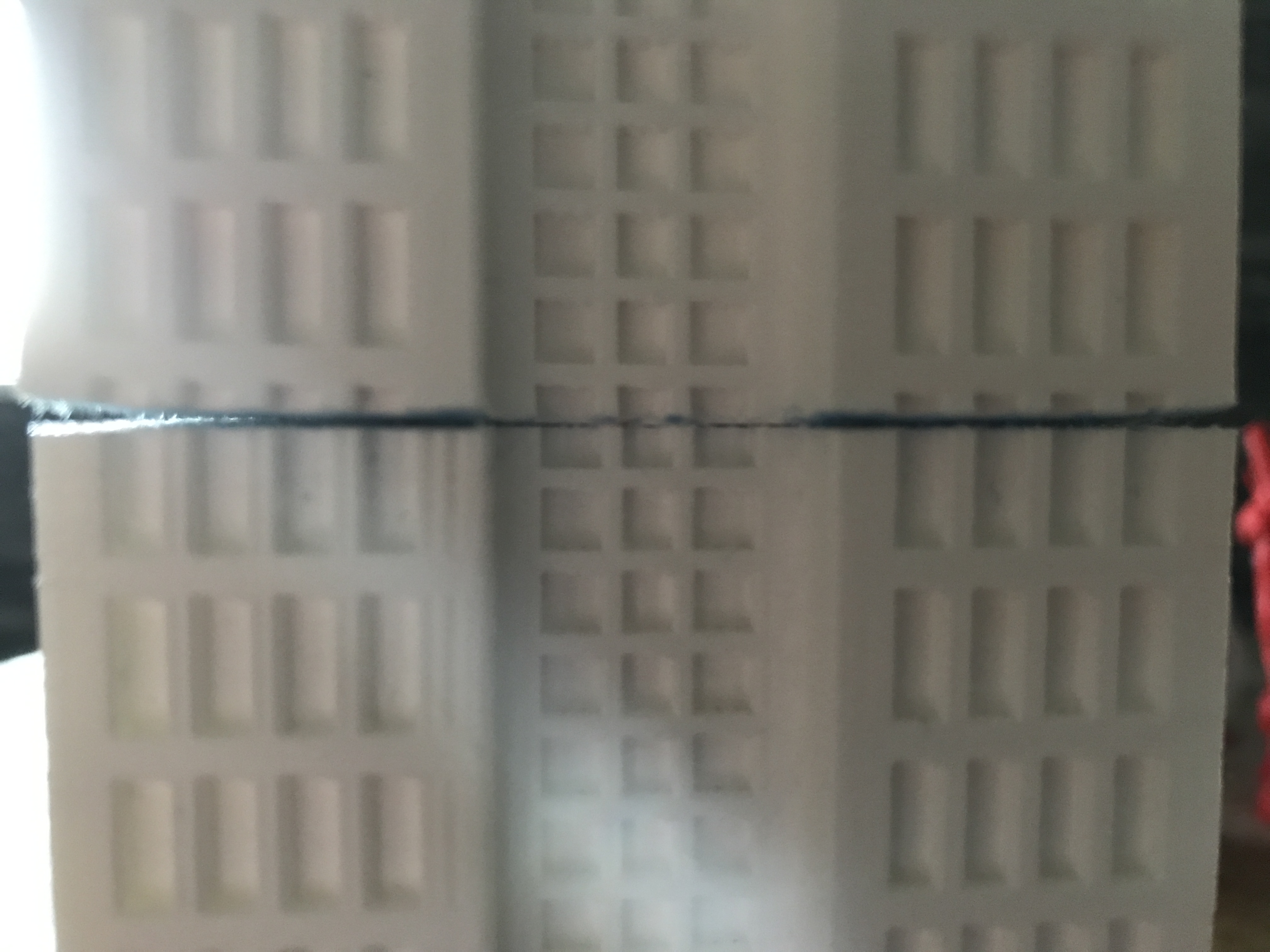

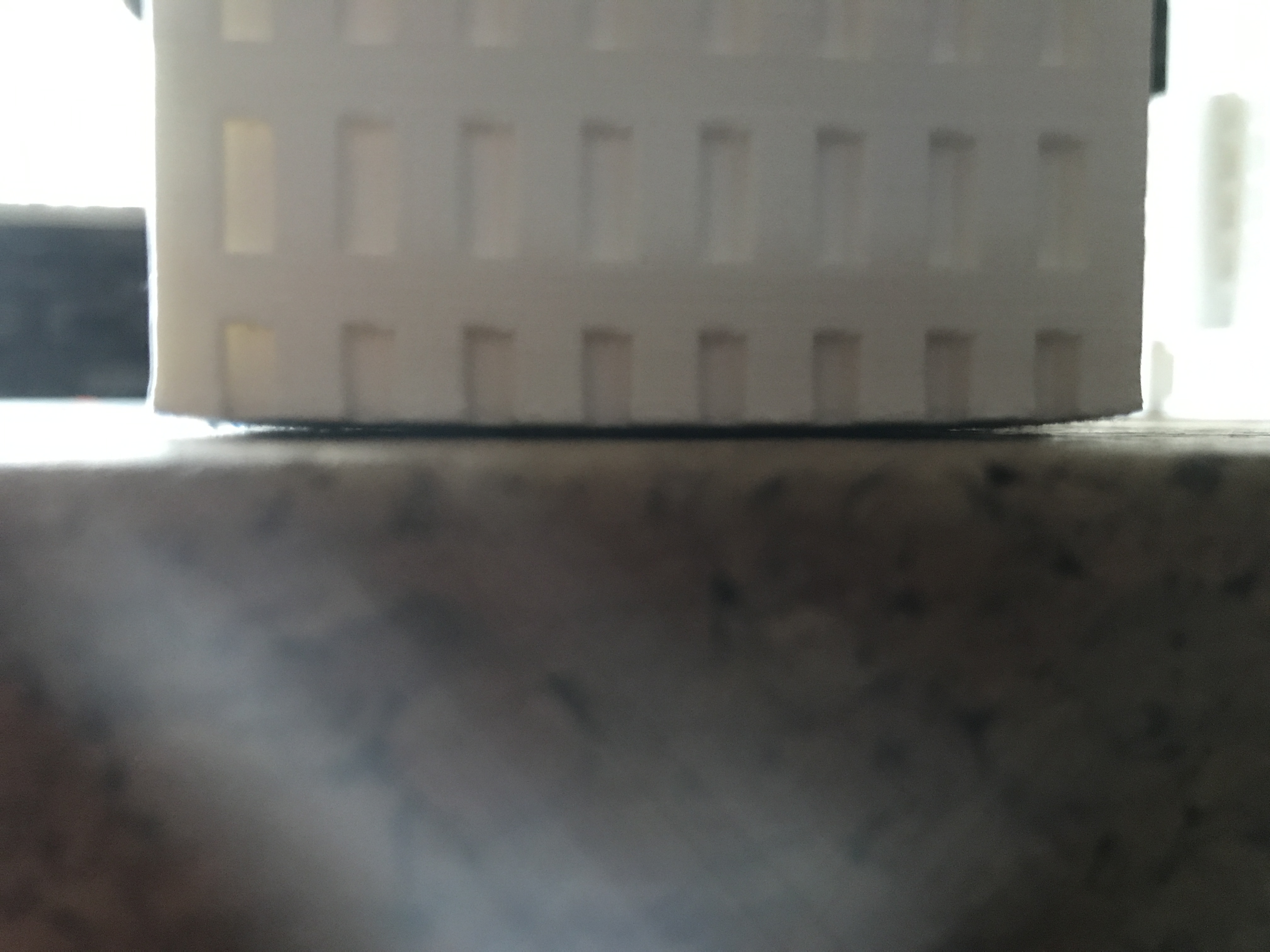

Hey so I just spent like 30 hours on a really big print sliced into 2 different prints. But the bottom surface of the top part came out uneven, which means i can't put them together.... Printing with high temperature PLA
Here's some pics.
What can this be?... Here's the profile used aswell on my Flashforge Finder.
FlashForge Finder.fff
(15.04 KiB) Downloaded 584 times
Could it be a simple calibration of the bed? Or maybe the first layer settings? help me out please... thanks

You don't say what your material is, but this looks like a classic case of "warping". It's very common with large parts. PLA is definitely prone to this, but it can be a problem with most materials.
Check out the warping section of the S3D trouble shooting guide:
https://www.simplify3d.com/support/prin ... g/#warping

That is probably pretty "warpy". It's really an issue of shrinkage due to temperature changes, so the hotter you extrude at, the more it's going to want to shrink. A heated bed helps, running the extruder at as low a temperature as possible helps. An exclosure (heated if possible) also helps. Basically anything you can do to keep the print warm until you are done is a good thing. Beyond that, you are stuck with trying to keep it firmly attached to the bed until you are done. That's where rafts & brims come into play.
