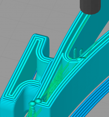

I'm printing something in flexible TPU material, which is especially susceptible to oozing/stringing. It's a protective sleeve for a device to slide into, and I was trying to reduce the amount of cleanup on the interior I needed to do after printing. Turning on "Avoid crossing outline for travel movements" fixed the stringing issue, but the problem I'm running into is that I'm printing in a clear filament, and this option causes the nozzle to travel along the outline, causing a really annoying pattern in the printed material making it not come out clean/clear:
https://www.dropbox.com/s/ltqolymmuuy86 ... 1.png?dl=0
It would be very nice if this option could be tweaked so that the travel movements actually took place outside of the outline rather than along it.

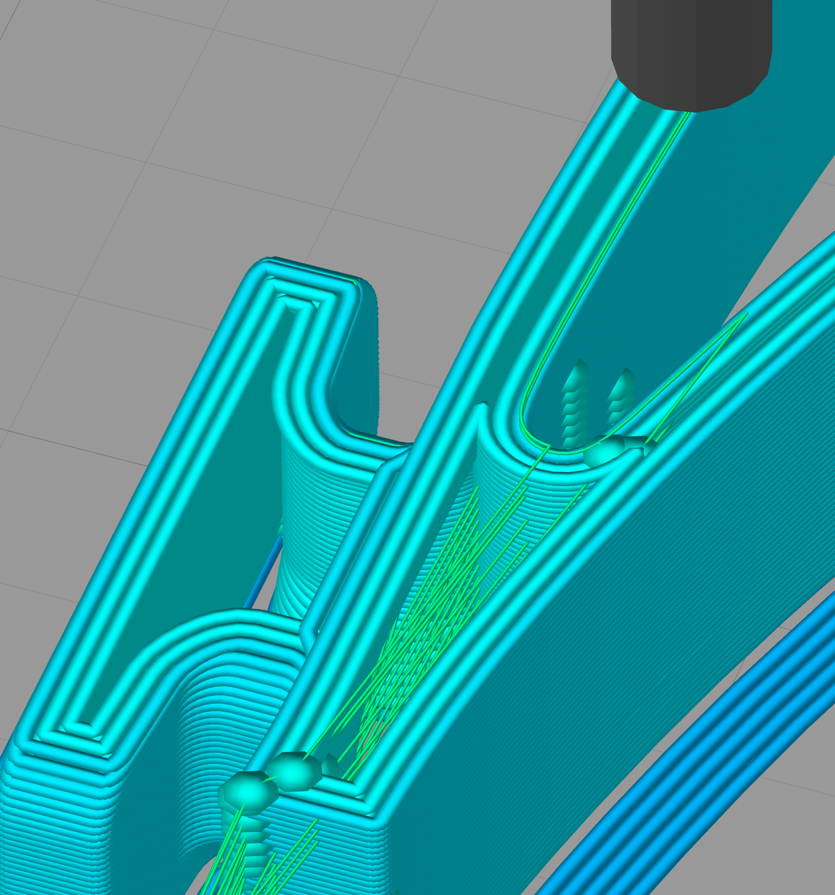

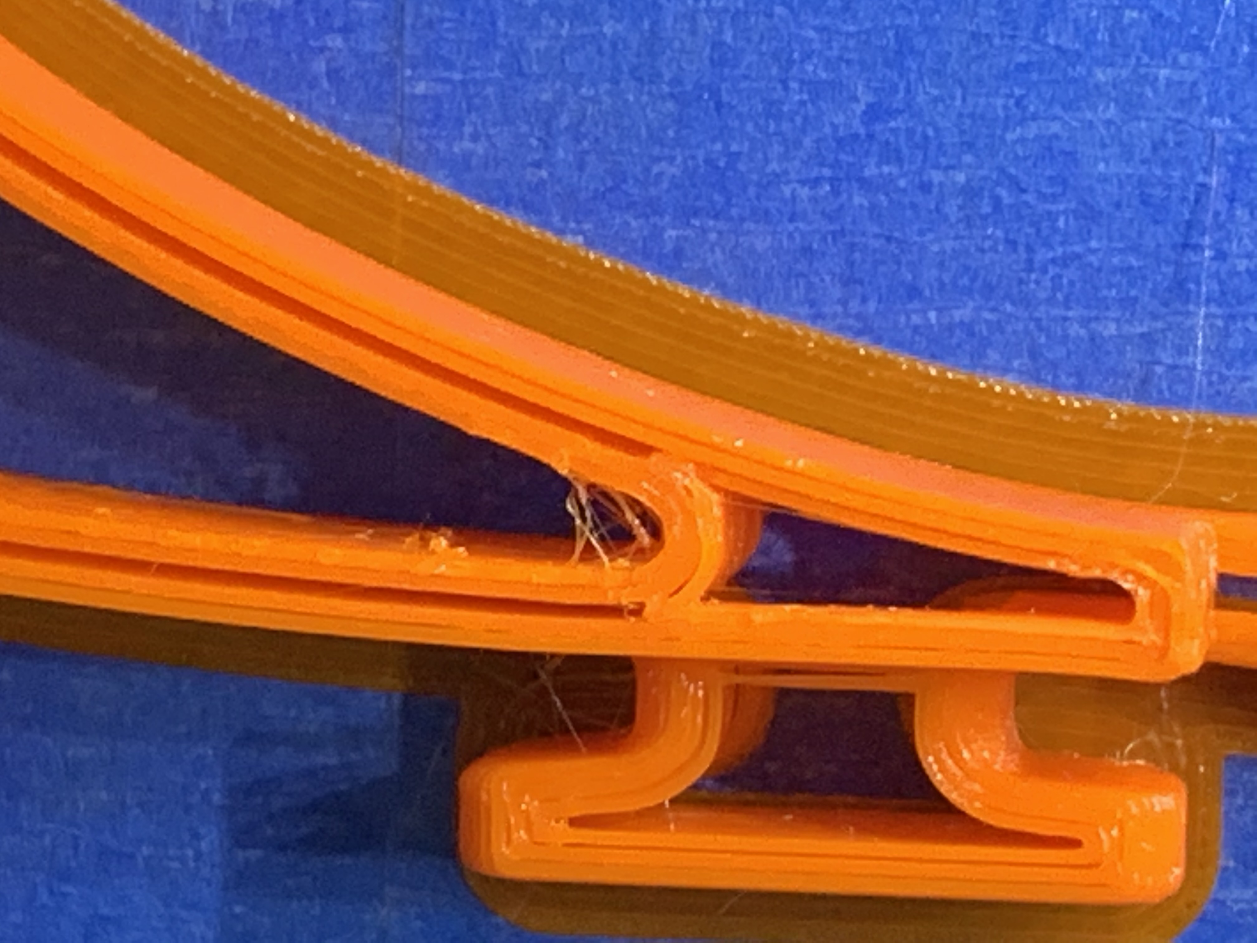

Not only does the travel follow the outer perimeter, but the path seems unnecessarily complicated. I've attached a screenshot of a travel path to illustrate, and the corresponding part of the print. You can see that because the travel goes around a tight corner, the string goes outside the outline because it doesn't stick to the model. This wouldn't happen if the travel path was more direct. Also it would shorten the print time.
How is the feature request for travel along inner perimeters or infill going?
Re: Improvement to "Avoid crossing outline for travel movements"
zzjlamb wrote: Sat Apr 11, 2020 9:51 pm Not only does the travel follow the outer perimeter, but the path seems unnecessarily complicated. I've attached a screenshot of a travel path to illustrate, and the corresponding part of the print. You can see that because the travel goes around a tight corner, the string goes outside the outline because it doesn't stick to the model. This wouldn't happen if the travel path was more direct. Also it would shorten the print time.
I believe the designed intention in your screenshot was for the travels to move along the existing perimeter until it's at the closest point before needing to cross. Meaning that the shortest travel possible will be used once the nozzle needs to cross the outline. As for it being unnecessarily complicated, that's really not something this feature has an opinion on. It takes the path along the perimeter to the point closest to the next printing location.
