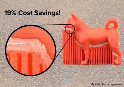

With the addition of a configurable tool selection for dense support (basically interface shells) I no longer have to worry about using more costly support filaments (HydroFill being my favorite). However as it's an alternate material moving from an alternate tool, being able to configure underspeed for the dense support would be advantageous.

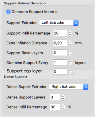

Also the wording on the extruder selection dropdown UX element has a typo :P -- "Dense Suport Extruder"

Simplify3d now offers the „dense support“ feature in version 4.0.0, i.e. you can just print the last 2-3 layers below the model with PVA, while printing the rest of the support structure in PLA...
… at least this is how it works in theory. In reality, I myself can't get a print with the „dense support“ feature and PVA on PLA to work . The PVA-layers (90% dense infill) just won't stick a bit to the PLA support and everything crumbles together at the nozzle.

1.) Add a configuration parameter for including a number of dense infill support layers on top of the normal support. These layers would still be printed with the choosen support extruder, i.e. PLA (extruder 1), and therefore the first PVA dense infill layer (extruder 2) would have more contact area to the PLA support and therefore will stick a lot better to the PLA. Here is an example of how the configuration tab could look like:
