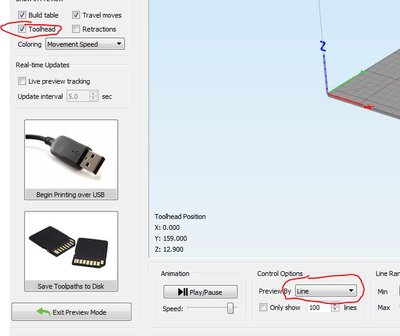

I don't use s3d to print files (octoprint is imo the way to go with telegram plugin and many other goodies) so can't help there but the play you are mentioning on the g-code view page (simulation) will work as you want it (line by line) if you change the "control options" section of the screen, "preview by" dropdown to "Line" instead of layer. This way you get animation of toolhead actual movement.
maybe the same thing will help with your actual printing of files

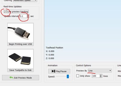

As far as the live update, since they added more option to preview things there are now more settings to adjust to updates.
first
check live preview tracking
change update time to "0.1"
and change preview by to "line"
and it will update every 0.1seconds by lines. default is but layer and every 5 seconds. maybe the fast update is to fast for some computers and printers/computers? Now if there was a way to change the defaults?

curious aardvark wrote:When printing via usb, 3.1 would show me a 'live' animation in real time of the print in progress. 4.0 does not. Just shows the static printhead and occasionally updates the model - but I no longer get a live animation of what's being printed.
I'm running a print right now and this works fine for me. I'm guessing you have the preview set to layer mode instead of line mode. That means that it will only show a complete layer, so you would only see an update after each entire layer is printed.

by curious aardvark
Ah ha !
Thanks, that works :-)
