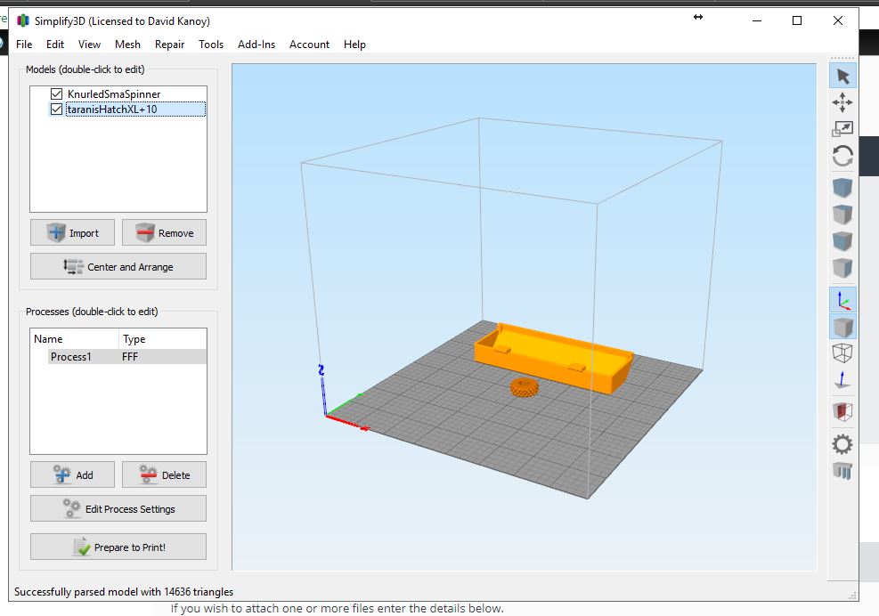

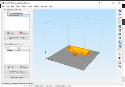

Ok, I closed and reopened the factory file. it still has two stl files and one process in it as far as I can see in the app. I reattached the factory fil.
Screenshot of what I am seeing in preview to follow.

screenshot
Re: empty gcode files being generated
There's something very, very wrong here! The factory file you have attached both times appears to be the same file....and at only 247 bytes long, it doesn't have anything in it!
Please do this:
1) Load the stl files you want to print
2) Add a process ...ideally the process you want to print with
S3D should look EXACTY like the screenshot you have just posted
3) Now...save the factory file...using Save Factory File as
4) Attach the newly saved factory file to a post.
