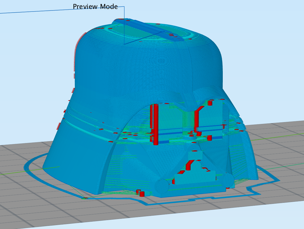

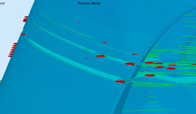

Problem with 2.1 Slicing
I am having some issues where there are gaps in the sliced model with 2.1. Otherwise it is much better. The quality is amazing. Hopefully this issue gets fixed.

Re: Problem with 2.1 Slicing
Vinny, have you checked the model in netfabb? Looks like the model has problems. Also in the advanced settings in the mesh section you want it to heal not discard.
I don't see any error in kisslicer. Its this one: http://www.thingiverse.com/thing:147446
Both versions of S3D show this. Makerware doesn't, but it was placing support material in some odd places at the right side of the helmet.
I suspect there are some issues with the model.
Yes there is a problem with it. I opened it up in netfabb and its not closed. There are errors in it which are causing this to happen. Open in netfabb and run a repair on it.
Ok my apologies. I thought I printed this one before with simplify3d. I also want to say that the new update is awesome. The seam is fixed and it interpolates the perimeter speeds. My other prints look great.
