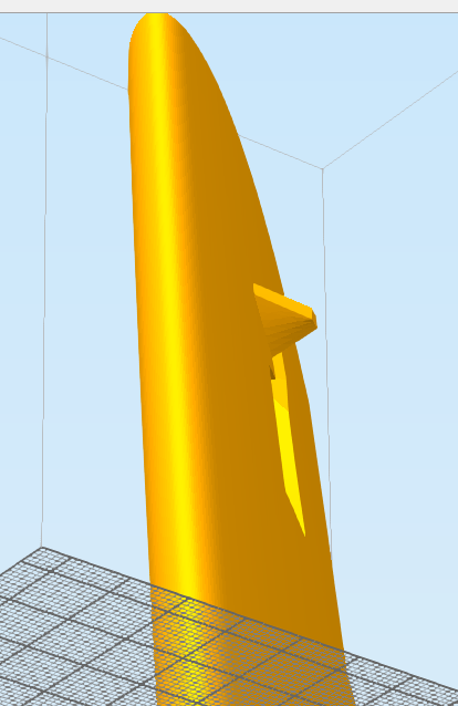

The slicing machines of version 3.11 and 4.0 are different, the one is tolerant against issue or impossible printing problems, te other machines does it not so. These problems occured in this forum sometimes.
V 4.0 crashes perhaps because your model wingL-2 has a impossible "nose" to print. V 3.11 shows this area, but it print it in plain air.
H.

I have extracted the models from your factory, imported to version 4.0 with my own printer profile and prepared them to print.
There is no problem.
Nevertheless the models have issues, they are not manifold and netfabb can repair it.
Please note that the fixed models (manifold) now have walls round about.
H.
