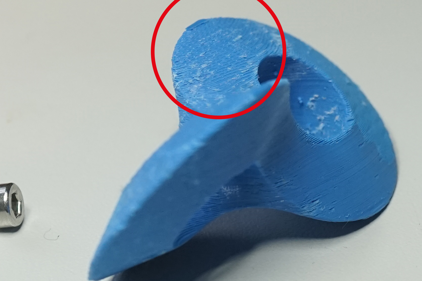

Hey Simplify3D Community,
i came across a Problem which i didn´t saw before i used soluble support. As you can see the Support structure is placed like a Gap fill in a Jagged line.
Of course this Structure is visible if you use a small offset (like you should with soluble support): This pretty much ruins the beauty of a soluble Support because it doesn´t look that much better normal support.
I think one or two Perimeter between the Support Structure and the Model would fix this issue.
I also got an Idea for a (not so practical) workaround:
Generate the Support Structure yourself and place it as a seperate Object. Allthough that should work with normal bodies, its no help for complex geometrys.
So im requesting hereby a Perimeter feature for Supports
