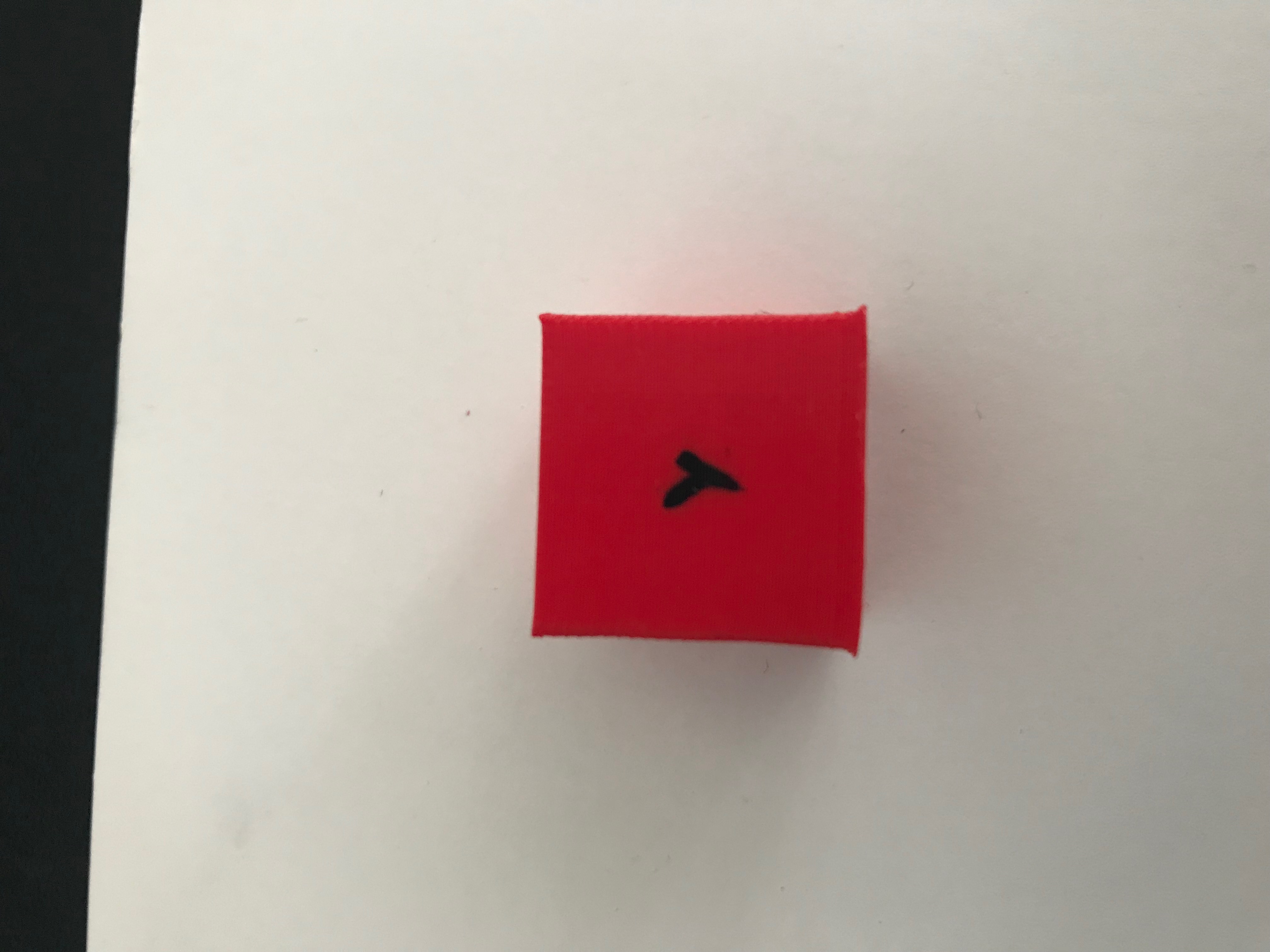

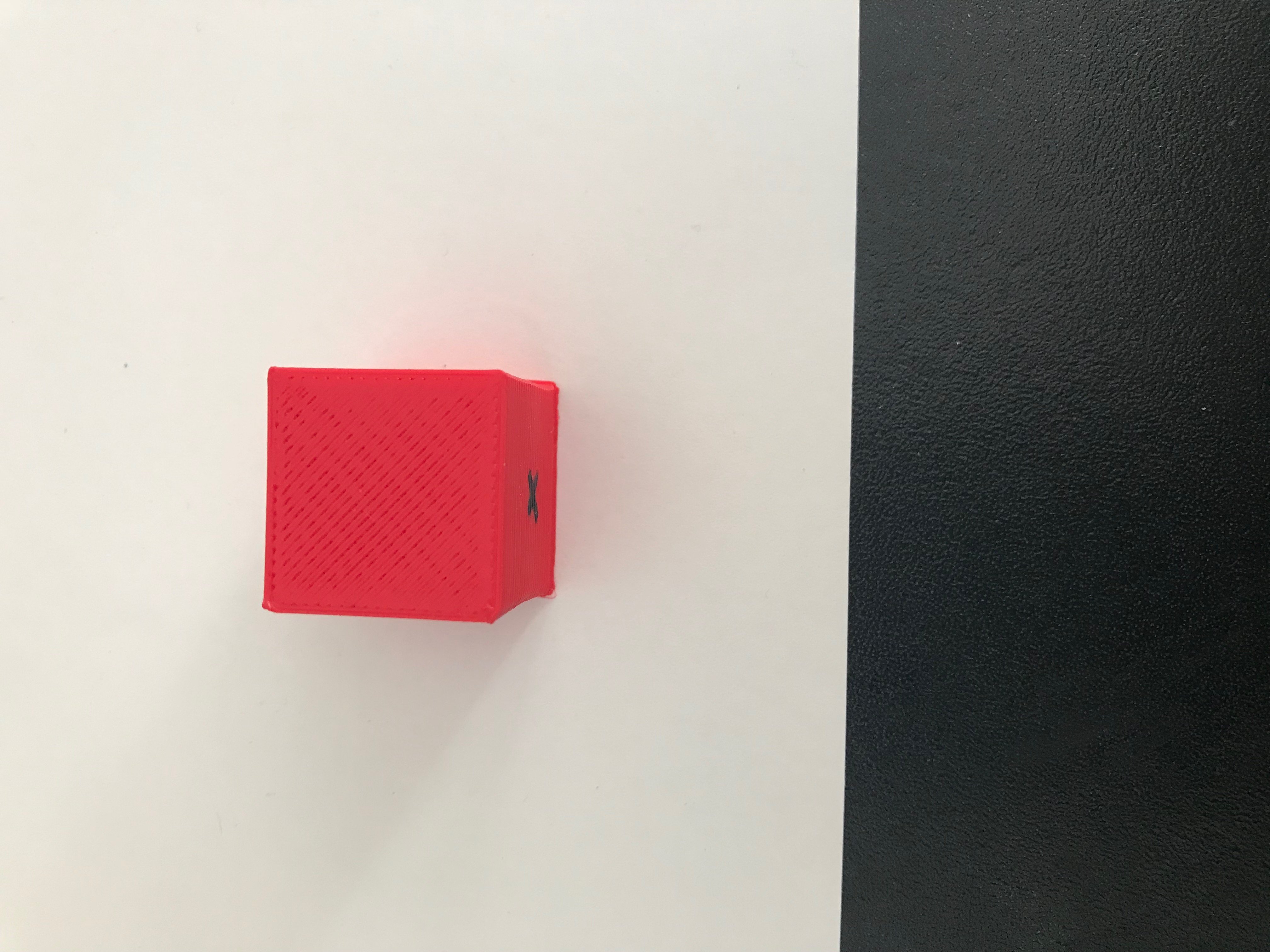

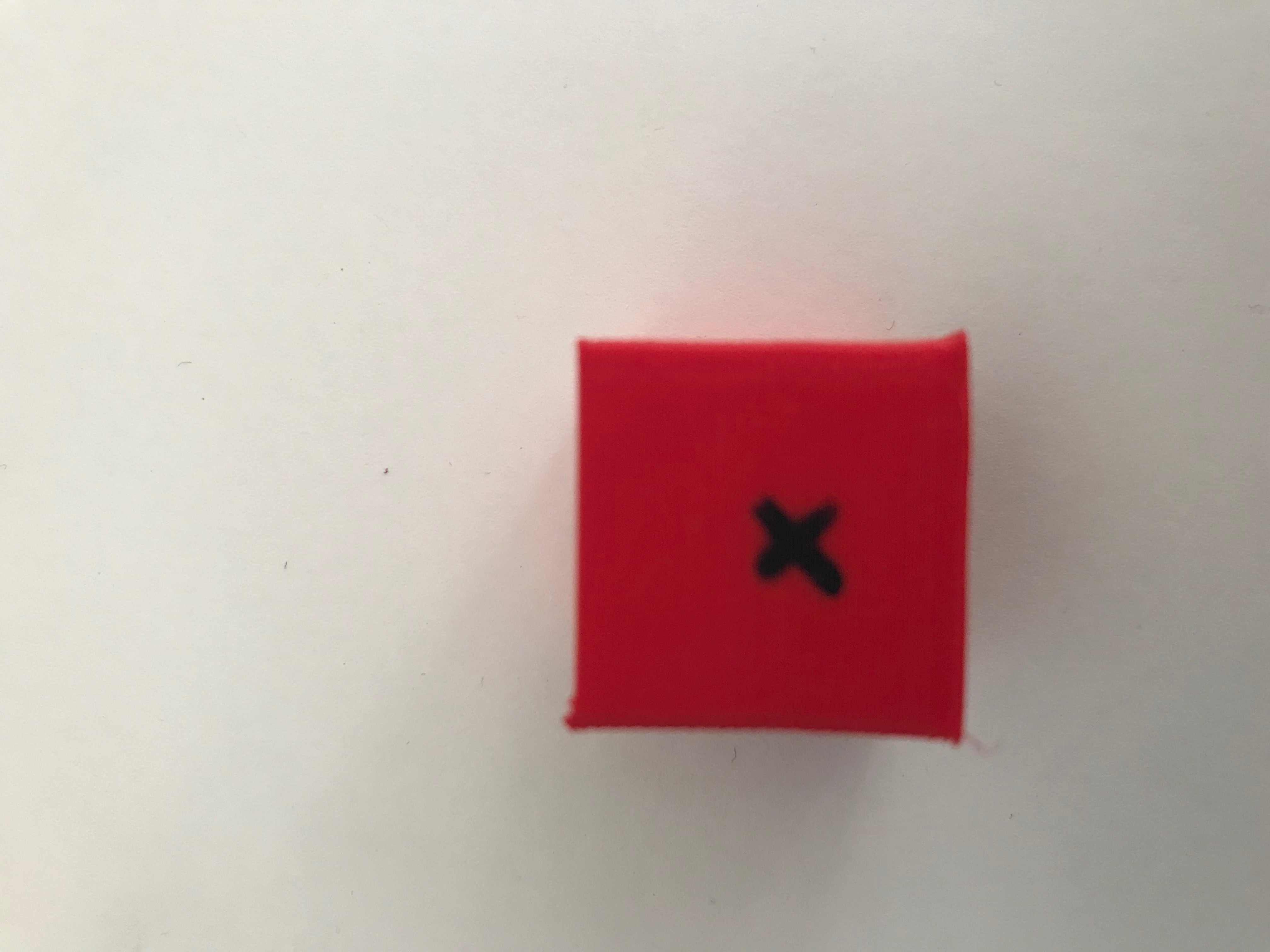

Hi, what settings should I edit to print the cube correctly.
I put pictures I hope they are understandable.
Thank you
arhi
Re: Elephant paw cube
the standard elephant's foot solution consist of combination of:
  • before anything else - make sure your bed is leveled properly
  • lower heated bed temp
  • increase cooling of 2nd+ layers
  • raise a nozzle a bit (the 0 height of the nozzle, get it up a bit, you can do that using Z offset in advanced settings)
