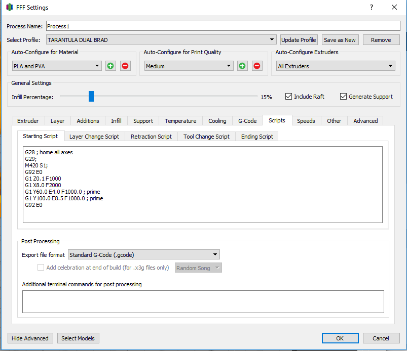

I'd say, issue M503 manually and see what it says for itself in the log. You might be lucky enough to be able to save it to EPROM. And if not, hopefully issuing the M92 commands in the startup script will suffice. Which is where you'd likely do it. Attached find a picture of the tab for the startup script in my process. I don't issue that particular command. But very similarly, I need to enable my bed leveling at the start of each print. And you'll see I issue M420 S1; to accomplish that.
