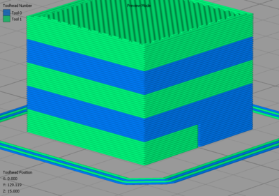

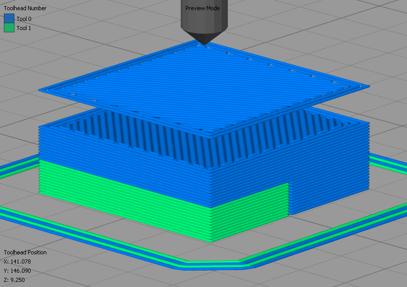

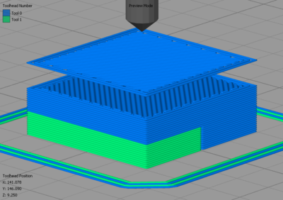

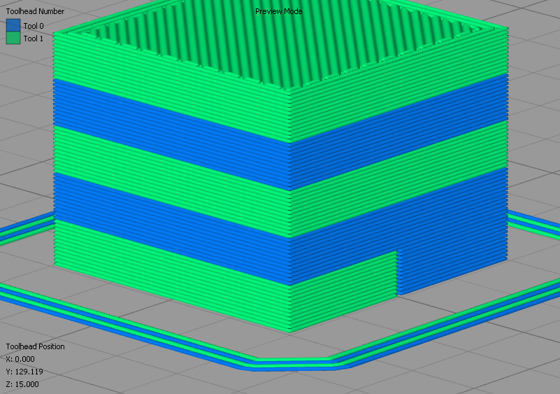

Just picked up a dual extruder for my machine. Got everything dialed in and calibrated. I just designed a quick test model to check the offsets the two heads and when viewing in preview mode it jumps the Z height 3mm and starts printing the bottom layer of the start point of the same tool head, then lowers back down to switch tools and continue.

Complete Layers
Complete Layers
Layer Jump
Layer Jump

I’m happy to state that this issue should be resolved now in the latest 4.1.0 release. Our team successfully tested multiple factory files from threads mentioning this issue. These layers will no longer slice out of order when setting up dual extrusion prints. This was just one of many improvements to the software. All of which are detailed on our Release Notes page.
