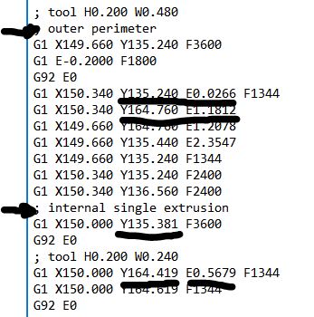

My problem: I am printing with a Y-piece and am switching tools with a tool change script. Maybe this screws up the single extrusion feature.
If this is the case I do hopefully find a workaround...

ok...just started a simple geometry. It's working fine with single extrusion which is smaller than standard width (see pictures)
--> I try to get out where the difference to my "real" model is. It seems that he tries to realize a single extrude which is bigger than one standard width

blackbird2016 wrote:I shortly examined a gcode and saw that for the single extrusions there are "tool-switches" from one to an other with different diameters...
It isn't an actual tool change command. It just changes the E-values for how much plastic will be extruded. So even if you are using a custom tool change script, this won't affect you.
