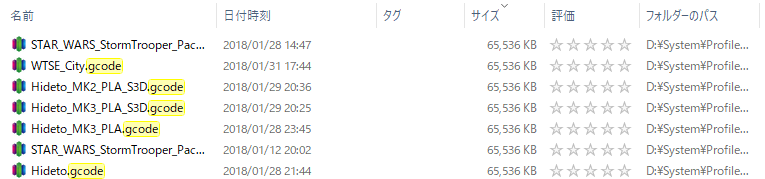

Also, I noticed that:
1) when you open the problem gcode file, it has a bunch of null at the end of the file.
2) File size is all 65,536KB (see attached picture).
same filesize.
same filesize.

Sounds like you need to upgrade to 4.0.1. I think this was something that was fixed in that version.

Yes, do the upgrade to 4.0.1 and it should fix issues with files over 64MB.
As was said earlier, log in and download version 4. It will say 4 but the file name should say the correct version.

After I posted, I noticed a 4.0.1 version. Installed the update and I was able to print.
