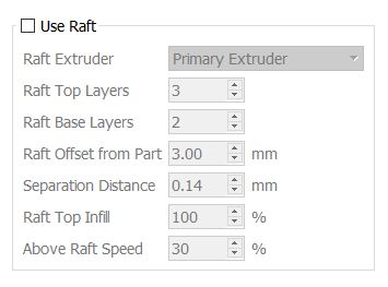

I have used rafts while printing D&D miniatures and have had no issues using the settings listed below.

The 2 settings you would want to alter (no idea what they are now) is Separation distance and Above Raft speed (first layer of part)
The speed is a % of some speed all of which start with over all speed. So if you are printing a 60mms you may want to make 2 processes and have the first print to the 3rd layer at 30mms then switch tho your 60mms..
