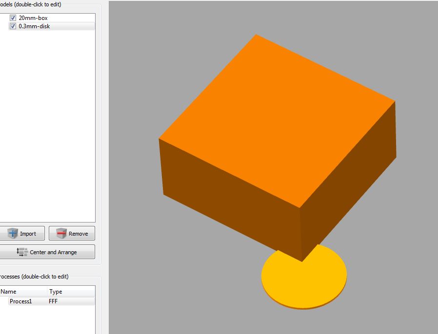

I would like to see the addition of a feature so that you can choose where you would like your brim or skirt to be and the length. Similar to tabs when doing CNC routing. I find the brim difficult to remove in intricate prints.

you can do it manually .. there was a video somewhere on the forum showing it but the idea is make a 0.2-0.5mm thick "disk" 5mm radius for e.g. and then put it on your bed in places where you want to reinforce the bed adhesion, for e.g. on corners of your parts
