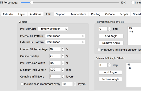

Strength depends on several factors. I print only engineering parts and find the best settings for me (and my prussa printers) are:
[*CORRECTION - what was I thinking...}
Temp = 230(PLA) & 250(ABS). Depends on brand and age... I use eSun PLA+
Infill = Rect & Rect…
*infill = 10% (with rect/rect, that means 20% infill total). Bump it up if not what you need...
Shells = 3 (unless for threaded boss, then I use 5 shells)
Layers = 3
Height = 0.2mm (sometimes 0.3... ) always depends on the part....
see image
3D Print Parts
