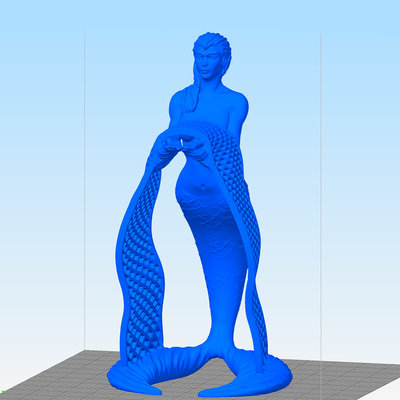

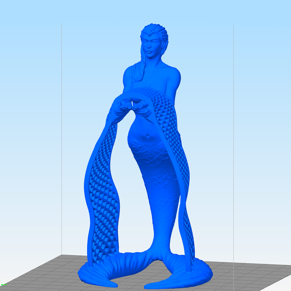

I'm trying to print the attached model photo which has a 300 mm height. The problem is that as the print keeps building up, the toolhead/nozzle starts hitting the walls during movement, like from right to left, until it breaks them.
I tried printing the model with my 3 extruder printer and one extruder printer but still have the same problem.
Is there anything I can do with S3D to prevent this from happening? Like to have an extra Z lift during movement between separate layers?
