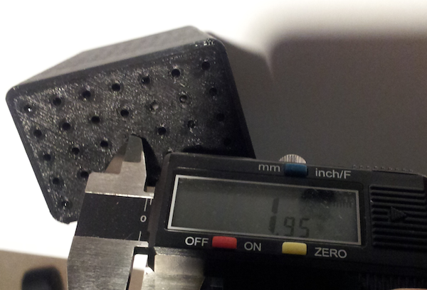

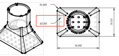

This week I designed a thing with small holes; the goal diam = 2.0mm, the printed result is 1.95mm (the difference of 0.05mm is one-half the thickness of one hair). To get that result, the model uses 2.2mm diam.
Note, I measured with calipers, thus some inaccuracies due to the flats as opposed to using a measuring dowel. If I used a dowel, the actual would probably be ~2.05mm and I did not punch-out the minuscule brim.
And, that’s on machines built from low-cost kits!
