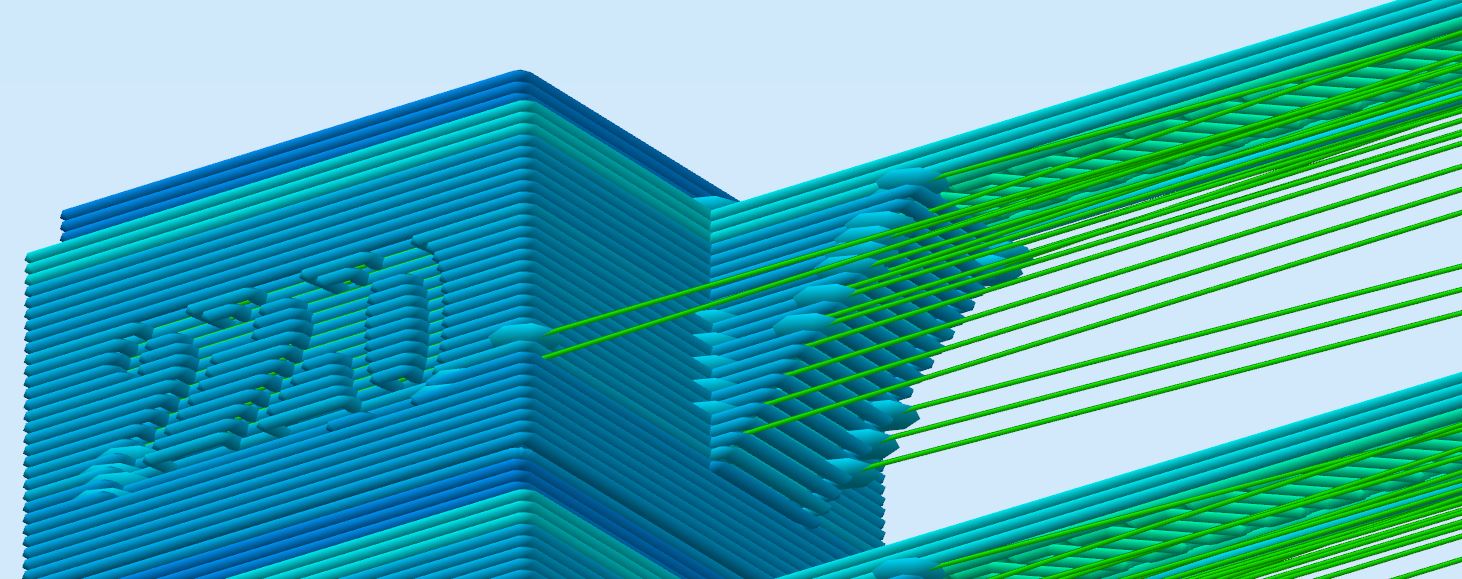

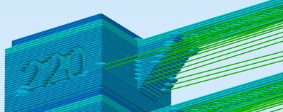

I tried printing a heat tower and noticed little filament loops hanging from the bridging.
When I checked the preview mode, I saw that S3D made the same amount of bridges as my perimeter shell count and then zigzags the space between the bridges.
I tried all settings but the only thing that helped, was to bump the permiter shell count so it covers the width of the bridge.
Any other ideas how to accomplish this without increasing the overall model perimeters?

are you using 4.0.1 ?
did you setup other tab, unsupported area thr. to 5, turned on "apply bridging to perimeters" ?

Try reducing the bridging area threshold. It might be too big for those small bridges.
If you're still having trouble, attach your factory file (it's hard to anyone to help without it!)

Thank you, yes I'm using 4.0.1.
I tried changing those settings but it made no difference.
Here's my factory file:
bridging_problem.factory
(106.33 KiB) Downloaded 423 times

Fixed......check the Bridging settings! :roll: :roll:
It took 30 seconds to sort out.....you should have taken the advice given!
220-260PETG_Temp_Tower_.factory
(106.64 KiB) Downloaded 338 times

dkightley wrote: Thu Mar 08, 2018 12:25 pm Fixed......check the Bridging settings! :roll: :roll:
I took the advice, and that did not work.
But it looks like you also enabled the "Use fixed bridging infill angle" option, which fixed the problem in combination with "Unsupported area thr. < 30"
Also this works only for one direction, which works with this model but other models with bridges in more than one direction would not work.

vindolin wrote: Thu Mar 08, 2018 2:34 pm But it looks like you also enabled the "Use fixed bridging infill angle" option, which fixed the problem
the bridging algo is not perfect/all knowing but at least now there is a possibility to force its way with "fixed bridging angle"
