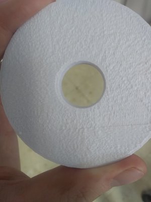

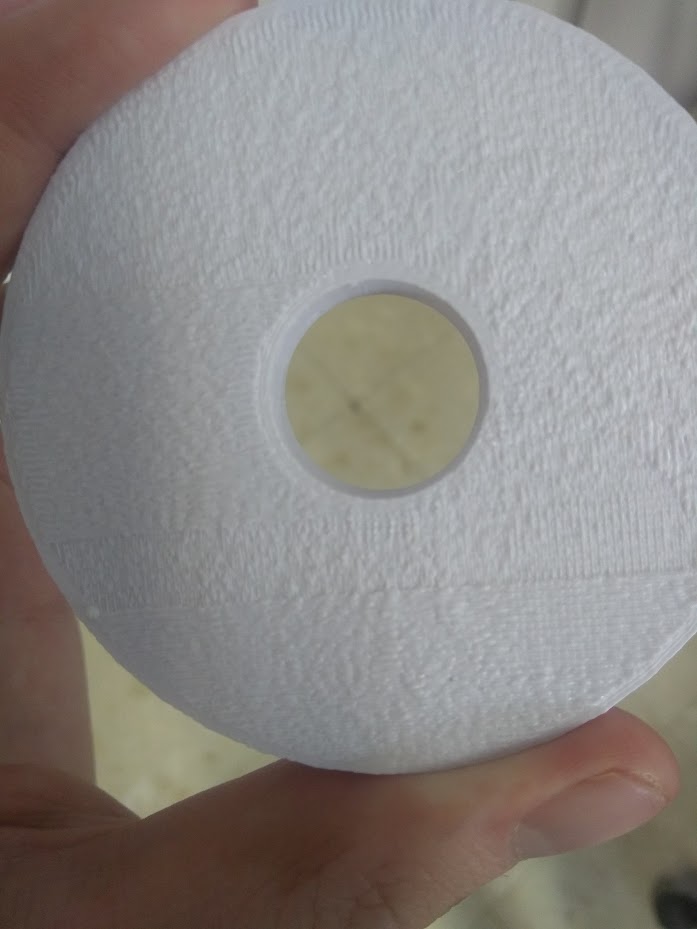

I had a part fail last night because the nozzle caught on significant blobbing and the build plate came loose. I figured it was too much outline overlap, so I dropped that and it didn't resolve the issue, I stopped the print today because I saw that it was going to fail soon. Should I decrease the extrusion multiplier? I need 100% infill for the part for reasons other than structural, so please don't suggest that. I have attached an image of the part that I stopped today to show the blobbing, as well as the factory file, I am printing on a Raise 3d N2 plus dual, but I am only using the left extruder.

Hi do you have any pics of the side of the piece
