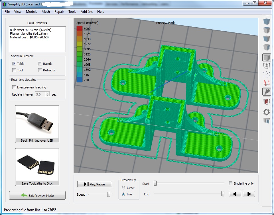

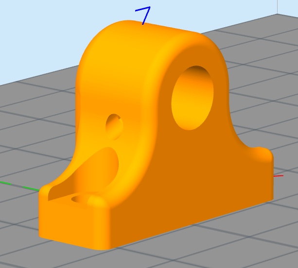

Hi everybody,
I don't know if I'm being silly or broke a setting somewhere but I'm having strange problems slicing a part from http://www.thingiverse.com/thing:41967
I've run the part through netfabb basic which finds no problems.

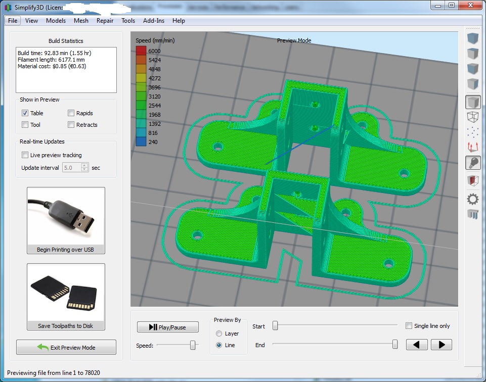

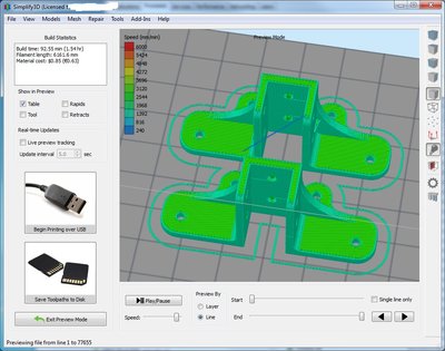

This funny thing is that I have two identical parts on the build tray, but they are sliced differently.
Also, exiting preview mode and re-slicing produces different results every time...
I also don't know why there are gaps in the outside perimeter...
Slice 1
Slice 1
Slice 1

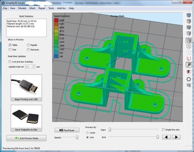

Slice 2
Slice 2
Slice 2
Thank you,
Errol

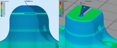

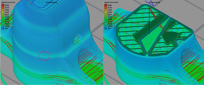

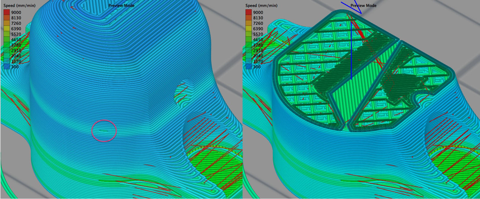

Here are two examples of the one part. The bad layers appear at the beginning and at the end of a horizontal hole.
I printed this part without any defect after modification of the first layer, but it is important to check slicing before printing.
Example 1: lack of material on a layer

Example 2: Small hole on a layer

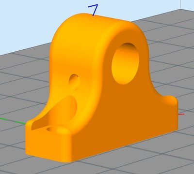

Part to be printed
Part to be printed

Wow, can't believe it. Changed first layer from 100% to 101% and now it slices fine. :)
