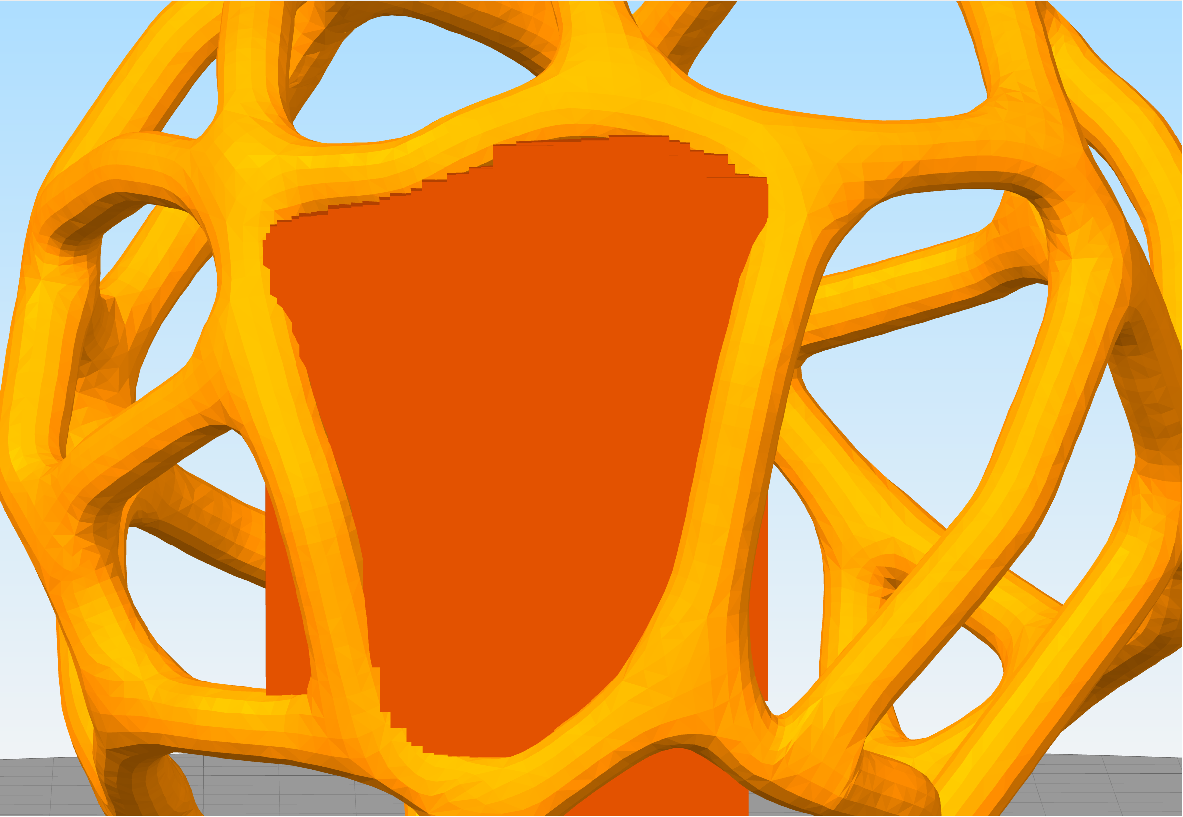

It's been my understanding that both are used in every situation. If you're printing an area that get's solid bottom layers it will use the upper separation layers and the horizontal offset if there is part below the supported area that will interfere with a support pillar's area.
This mesh ball is a good example. I manually placed supports filling up one of the holes in the ball. The pillars I placed left no area untouched between the top of that holed section and the bottom of the holed section. The software realizes where the pillars overlap with the part and create a horizontal offset from that section of the part. The software also notices where the pillar meets the top and bottom areas of the part and then either starts or stops the pillar the specified number of layers after the top of a part or before the bottom of a part.

This is my understanding also........
