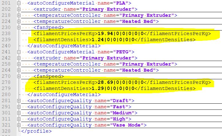

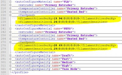

this will probably be improved with v5 but if you really need to match some settings like filament price/density you can
always do so manually. Export the profile, add the properties inside the auto-sections(material/quality) and you're good to go.
Note: Be careful when adding properties. One could set spiral/vase mode to enabled inside preset_A by adding:
Code: Select all
<spiralVaseMode>1</spiralVaseMode>
into a section. But when selecting another preset this won't be switched off again unless defined by adding:
Code: Select all
<spiralVaseMode>0</spiralVaseMode>
