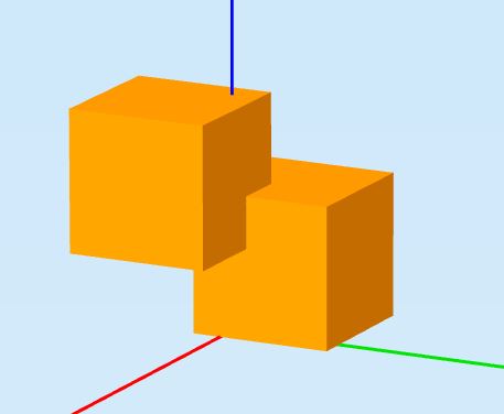

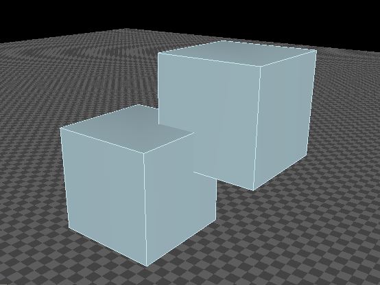

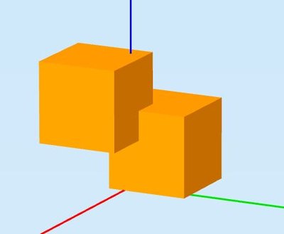

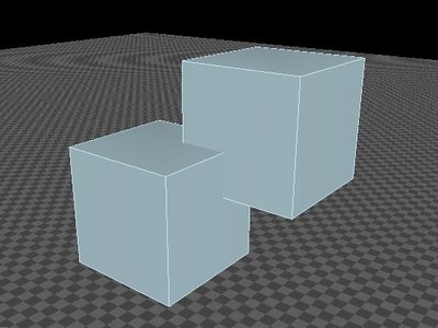

Lets take a couple of intersecting cubes:
These two cubes have been drawn as separate meshes. Export the two meshes together into an .stl file and then import into S3D and they look the same:

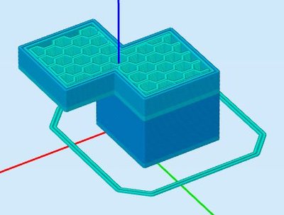

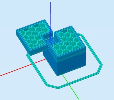

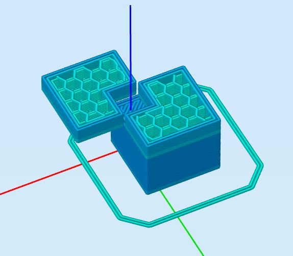

That is until you slice them:
What is happening is that where the two cubes intersect, the wall of one cube is interpreted as the wall of the other cube...and vice versa, resulting in each cube having a chunk missing and there being an included void. If this was to be printed, it may hold together...but would break apart very easily.

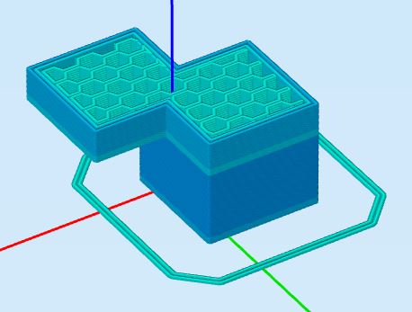

Now, by using the option Separate Connected Surfaces, the one object with two meshes is separated into two objects, each with a single mesh. The slicer in S3d sees these as two separate meshes and combines them before commencing the slicing......ending up with one solid object. See next post for image....
Re: Software cant slice multi part models correctly
See text in preceding post......
