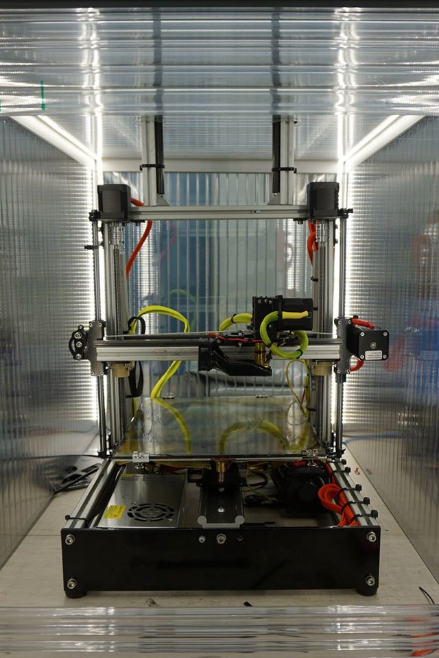

I have build an thermal housing for my mendelmax 2.5 because i only print ABS mainly big abs parts. ( 240mmx310mmx10mm)
During the printin i have NO warping but when the print is over and the bed cools down i get a little bit warping and thats not good because the parts have to be straight....

Ps: this is my Printer in the housing :)
