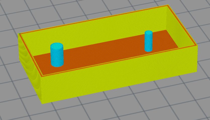

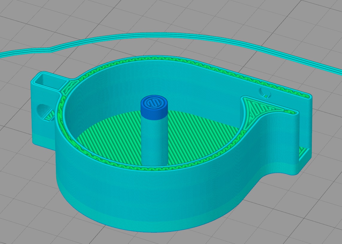

Re: Speed overrides on islands instead of layers
here is a picture to illustrate my point:
maybe there is a way to have the tower being deep blue on all its length but I couldn't find it (apart from disabling speed overrides and printing the whole piece very slow).
Is there a way to have the piece print fast except for the tower in the middle ?
