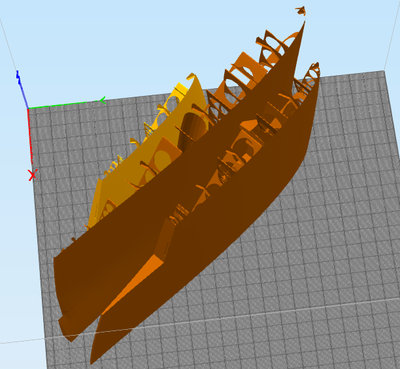

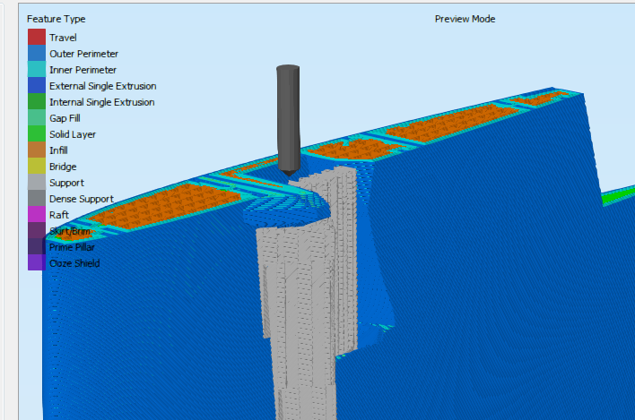

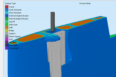

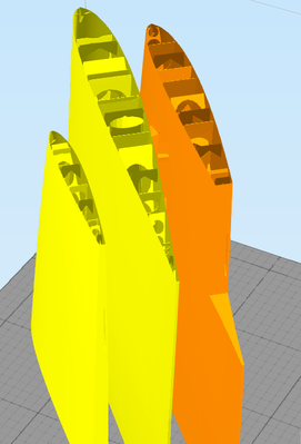

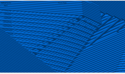

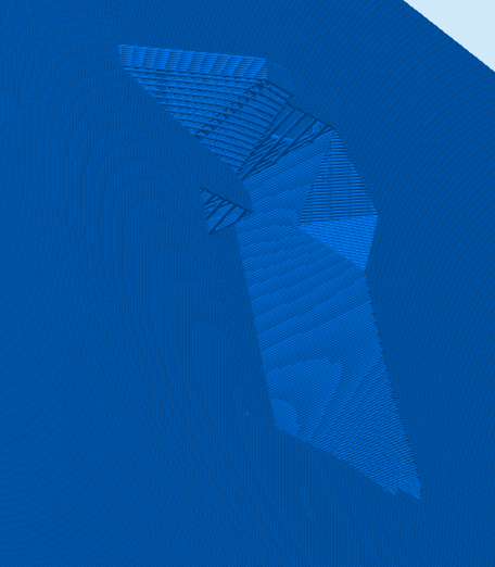

V 4.0 crashes perhaps because your model wingL-2 has a impossible "nose" to print. V 3.11 shows this area, but it print it in plain air.
H.

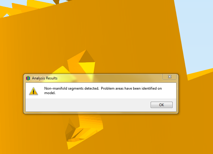

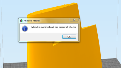

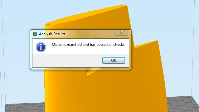

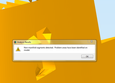

I have extracted the models from your factory, imported to version 4.0 with my own printer profile and prepared them to print.
There is no problem.
Nevertheless the models have issues, they are not manifold and netfabb can repair it.
Please note that the fixed models (manifold) now have walls round about.
H.

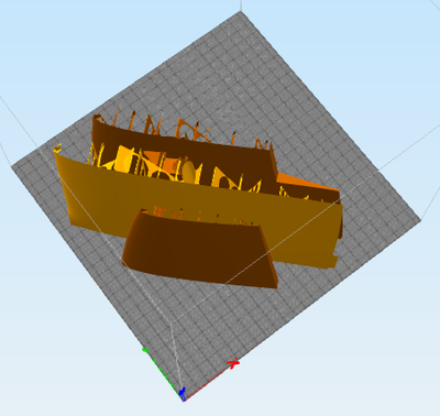

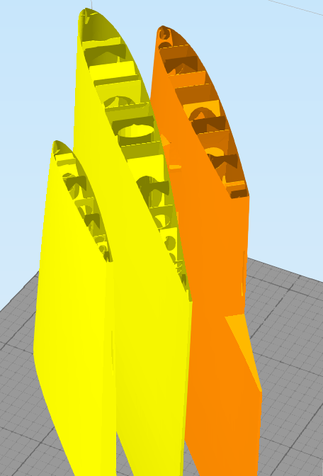

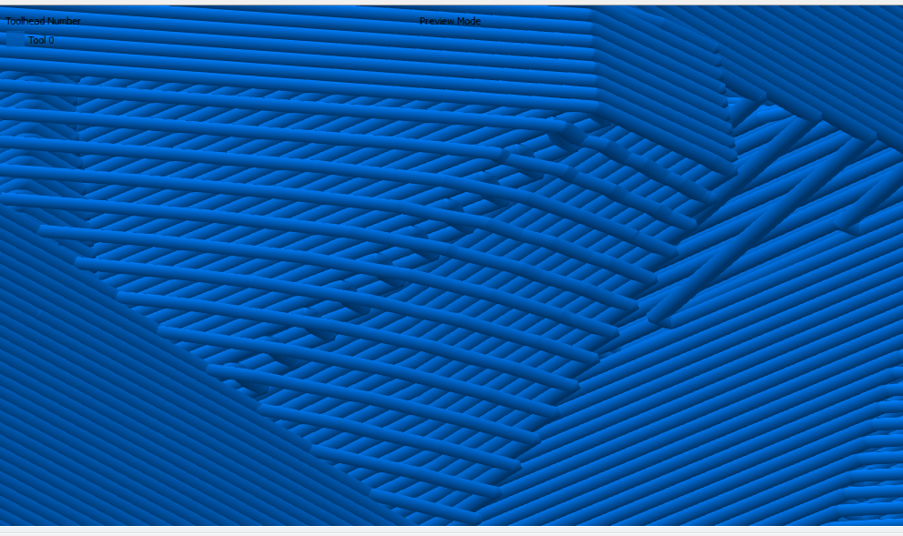

And as far as the image rendering on the models/processing page; this has nothing to do with manifold, but with zoom. If you zoom in or out you'll see all the thin walls are there. I think they deliberatelly not show one wall on a fairly zoomed out image, so you can see the structure. If you use zoom or walk around the model, the wall is there. These are all single thin walled prints. Probably by your 'repair' action you messed it up and made it more than thin wall (ie 2 perimeters wide).
ie now you don't see the wall:
and now (zoomed and rotated) you do:
About the model and manifold; it's totally not relevant. The model should just render to gcode fine, as it does in 3.11.
