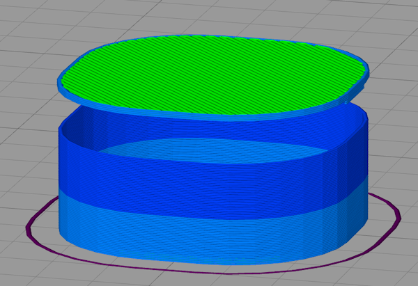

Thanks for taking the time to help. Here's a factory file that illustrates my issue. The side walls are 0.4mm thick and the top and bottom are 0.6mm thick.
It's made up of five processes to build a rounded box.
Section 1 - Basic Solid fill with no issues.
Section 2 - Perimeters Only selected under Advanced > External Thin Wall Type.
Results in the print head traveling out and back so to speak, extruding both ways. If you preview the slice by line and scroll through the movement, you'll notice nice, steady movement around the object
Section 3 - Allow Single Extrusions selected under Advanced > External Thin Wall Type
Results in layers where the print head only goes around once, but the movement is jerky and slow. Again, view the slice preview by line and you'll notice the extrude-then-pause behavior.
Section 4 - Extruder > Extrusion Width is set to 0.4mm
In this section the wall completely disappears even though the wall of the box is exactly 0.4mm. On the other thin wall layers I dropped the extrusion width to 0.38mm so they'd print.
Section 5 - Solid fill with no issues.

Re: Cannot Print Smooth Single Extrusion Curves (S3Dv5)
For section 2, you could easily use the Merge All Boundaries trick, but set the number of top and bottom solid layers to zero. That way it avoids looping around the outside + inside, but you don't get the solid fill you don't want.
For section 3, the jerky movements you see in the preview are just places where it is adjusting the extrusion width slightly to perfectly fill that corner. When the machine actually prints those movements, it shouldn't actually pause at those positions since the flow rate and the general direction of travel aren't changing. The machine firmware should have look ahead which will smooth all that out.
For section 4, even though the wall might be 0.4mm in your CAD package when you created it, exporting to STL typically adds some faceting error that could easily cause the wall to become 0.38mm or something similar. So it's not surprising you may need to adjust the extrusion width slightly.
Hope that helps!
