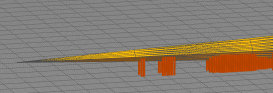

CompoundCarl wrote:You are just using too large of a pillar resolution. It will support that ear just fine if you use a smaller size. You can't expect it to pick up a thin ear like that with such a large pillar resolution.
If you need help, post the STL and I'll be happy to help
Sure you can, evident by other slicer software doing it just fine.
The printed resolution of the supports shouldn't be directly linked to how unsupported areas are detected, these values should be decoupled.

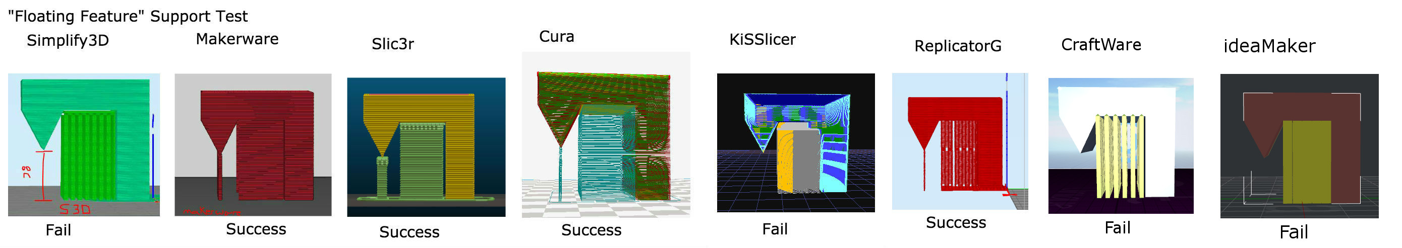

"Sure you can, evident by other slicer software doing it just fine."
Exactly danielhenley : Whether or not I want tiny support tower or a "big" big one, it should still not leave unsupported structures regardless. It should detect for the unsupported area, and then place either a small \ big pillar under it like... all the other slicers do I illustrated earlier.
No argument this is bad, whether you consider it a bug or a missing feature. S3D is great overall, and because of that it just makes stuff like this stand out even more.

S3D is great for adding supports manually. This feature request/bugfix is about it's 'automatic' support system, and how it's completely failing to catch unsupported features like previously described and illustrated.
If it encounters a shape like a floating " V ", as long as those angles are within the defined overhang tolerance it creates no support, which is correct. I don't want it to create supports where it shouldn't based on the overhang tolerance. But what it fails to do is supportof the base of the V, that's floating in space. Which then causes the entire V print to fail as it extrudes into unsupported space on the base. It appears to have no concept for items like that, which cause print failures on complex shapes without thorough manual inspection... completely defeating the purpose of "automatic" supports.

Just to bump this, since I still encounter it: I tested ideaMaker & CraftWare, they both fail as well with automatic supports. However, I learned that while they both provide manual supports like S3D, CarftWare allows you to arbitrarily angle you manual supports (rather than them always being vertical), which is pretty cool.s
