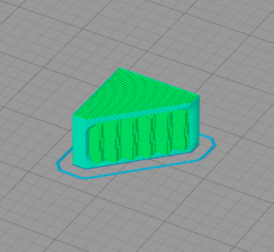

Hi, I would like to print a two-color piece. And a unique piece but what I would like to do is make the supports of another color, I have a two-color Creality CR-X with a split extruder (two in one). I can't find what setting I need to do to do two-color printing with the tower and purge / color change. What setting should I do,
You must insert some string in gcode if so which and where
Attached is the piece to be printed
thanks

Our team has a CR-X profile they can assist you with if you don't have it already. If you wish to do supports with the second extruder all you have to do is go to the supports tab and select the second extruder for printing supports. This thread should help. viewtopic.php?t=2135
