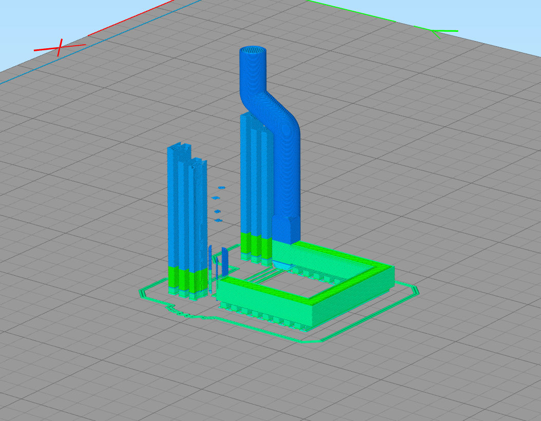

Hi I created a 3d model using fusion 360 and when I slice it in Simplify3d, half of it disappears. The image of the preview mode is here:

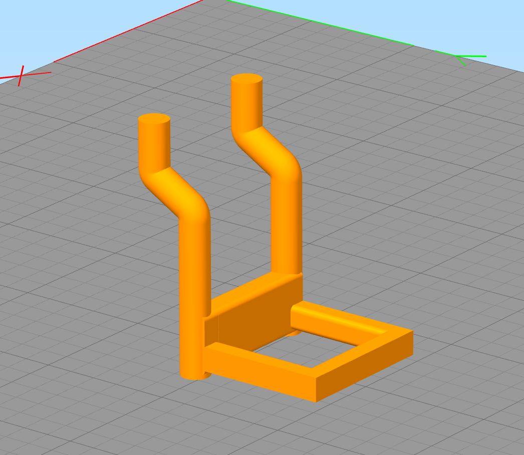

The image of the object is:
I wanted to note that Cura does slice it , so I don't really know why Simplify3d can't. Thanks for your help

The shape file has a number of issues that S3D is not able to cope with. I've run the model through 3DBuilder and it now slices correctly.
