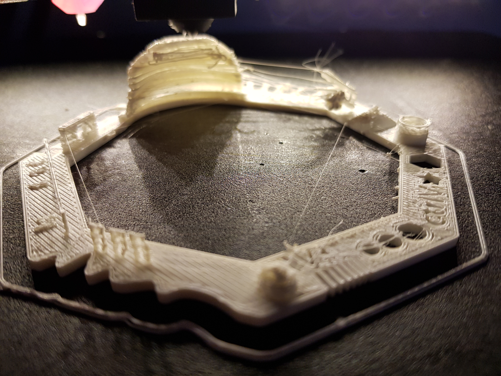

Hi All,
I'm new to S3D and currently trying to find the right settings. I'm using a CR-10S Pro V2 with Bondtech extruder and the default CR-10S pro profile from S3D. Steps for the Bondtech extruder are adjusted, also the voltage.
Unfortunately I still have some issues with stringing and layer separation. Let's focus omn the layer separeation first (will print a stringing test later). I attached an image from the print. Any help with finding the right settings is appreciated.
Thanks, Martin

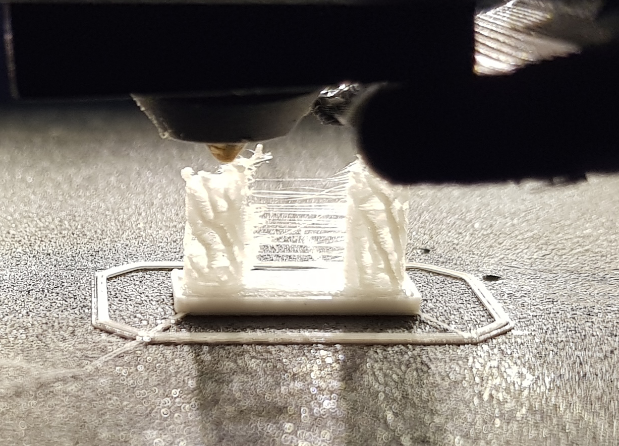

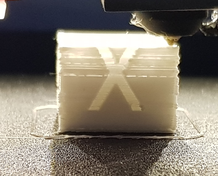

One more photo from this print:
http://www.thingiverse.com/thing:1363023
Horrible. The tower at the right side don't made it at all :?
Thanks, Martin

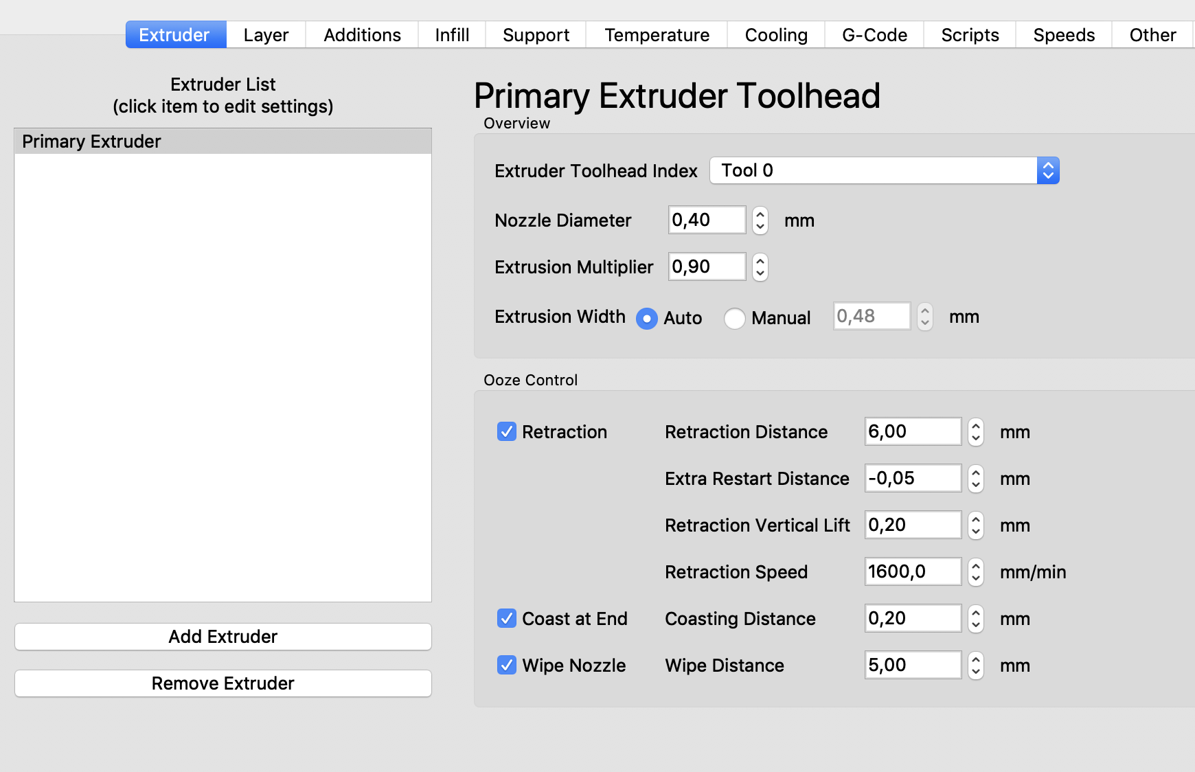

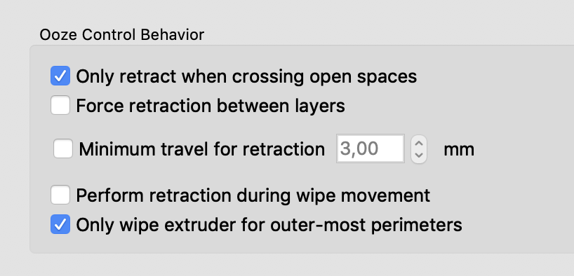

After a lot of test prints I think I've found the right settings now. No stringing at all :mrgreen: The main problem was that my retraction speed was way too high. Will do a final test print now.
Screenshots of the current settinsg are attached. I'm using a CR-10S Pro V2 with Bondtech BMG-M extruder.
Thanks, Martin
