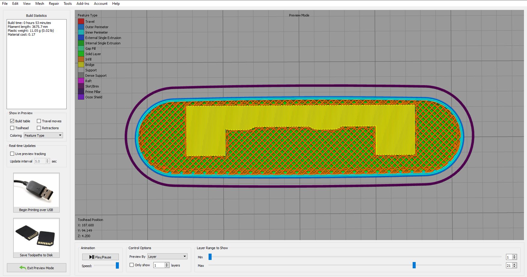

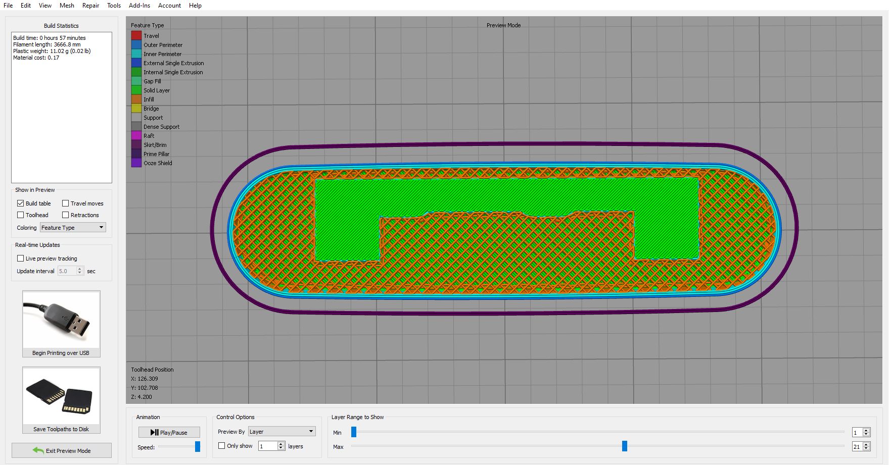

I have been trying to track down why my bridging setting was failing to be used and have managed to reproduce the error.
Process 1 has a layer height of 0.2 mm and needs to bridge over a hole.
Process 2 is used to smooth the top few solid layers by printing with minimal extrusion and a low layer height (aka ironing).
I have discovered that setting the Process 2 layer height to anything different to the Process 1 layer height causes the bridging to be ignored.
Setting the layer heights in the two process to the same value restores the bridging (shown in yellow).

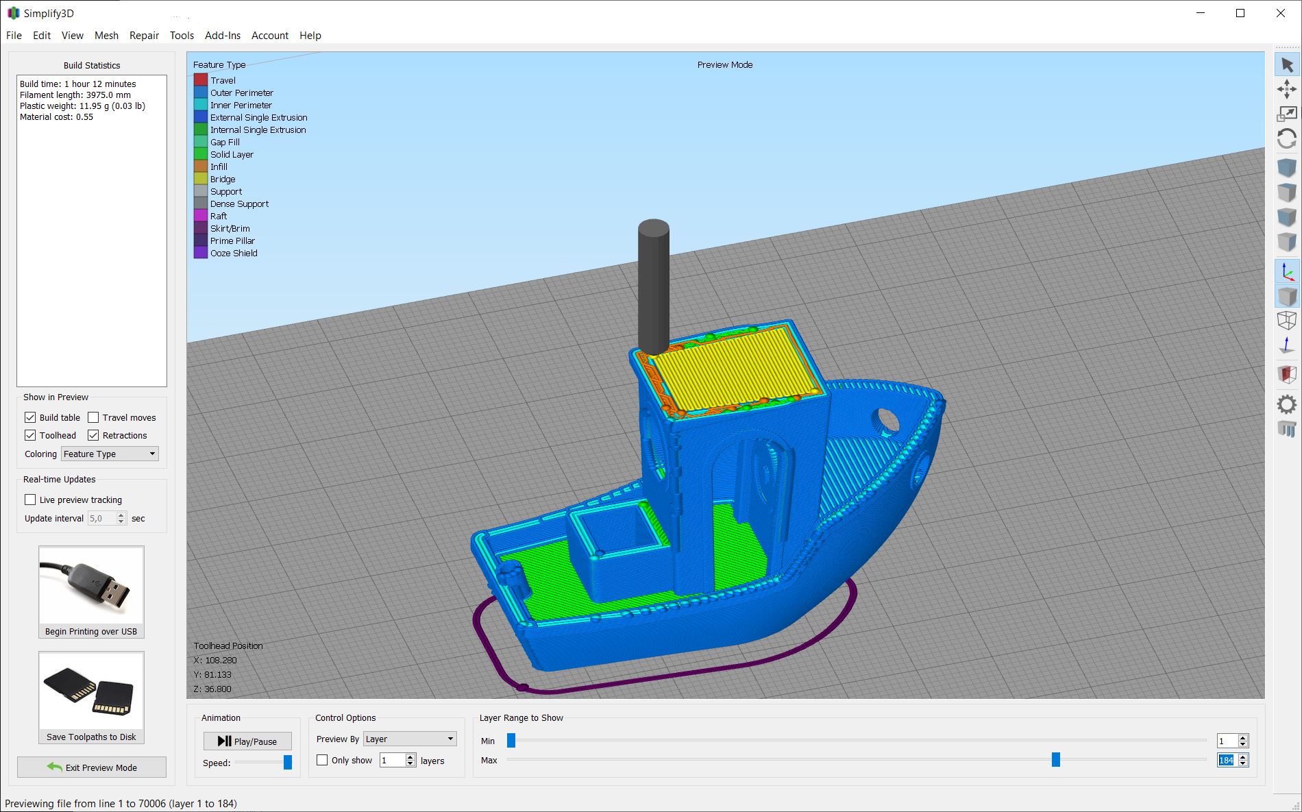

Would you mind adding a factory file to have a look at this (File -> Save Factory File as...)?
richgain wrote: Process 1 has a layer height of 0.2 mm and needs to bridge over a hole.
3dbenchy using two processes. P1 stops at 36.8mm using 0.2mm layer height, P2 starts at 36.8mm:
www.aunix.de/tmp/s3d/Benchy-Test.factory (4.5 MB, too big to attach to a post and ZIP is only 300k smaller, still too big...)
No matter what layer height I set P2 to, it won't affect the bridging from P1....

Sure. Here you go. The bridging happens on layer 21 when the layer height in Process 2 is 0.200 mm
Try changing the layer height in Process 2 to 0.020 mm and you should find that layer 21 no longer has the correct bridging.
