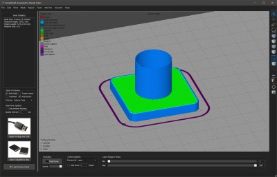

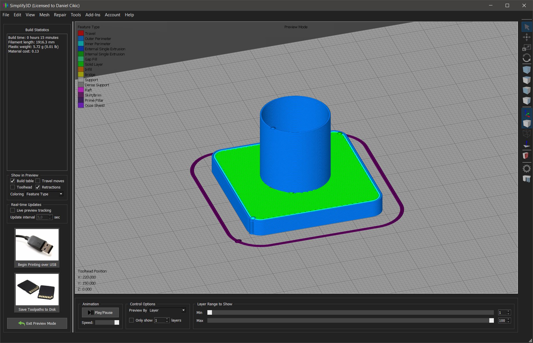

Did a quick test using a simple box and a cylinder, 1 process stopping at 5mm, the other one starting
at 5mm in vase mode for the cylinder. Can't see anything wrong right now...
