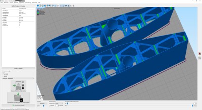

That's the Edge you have shown there. I tried the B25 as well and it didn't work. I haven't tried the Edge yet as I didn't buy that model.
Looking at those pics it looks like you have some setting that is filling in gaps. The green sections in the picture are not normally there. That could be why it worked for you.
Yes wing 1 parts left or right. Odd though...I checked my B-25 files and while Wing 1L doesn't have the inner structures...Wing 2 LR (what you have pictured) does have the inner structures. My Q-Trainer Wing 1 LR doesn't have any inner structures.
