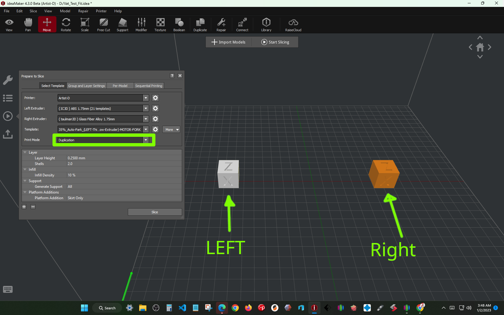

OK, so IDEX is supposed to be a new feature. Does it help, or do /i have to M605 what mode I want in start script? I was hoping for a setting in output that would let me select IDEX and that I could select mode and have simplify do the work for me and also give me a visual on the build plate.
I do not see IDEX support anywhere to configure?

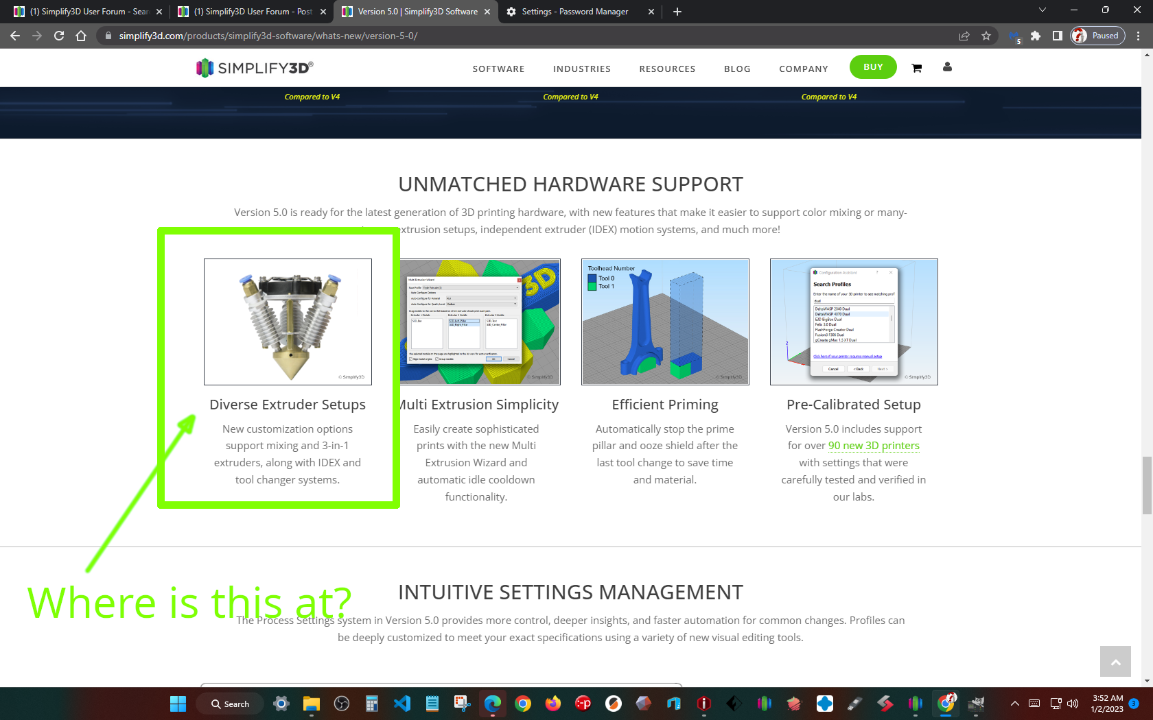

Where exactly is this at?
"Diverse Extruder Setups: New customization options support mixing and 3-in-1 extruders, along with IDEX and tool changer systems."

I know many of the printer profiles in V5 already include IDEX configuration options. You just select duplication or mirror mode at the top and then it takes care of everything else.
Can you confirm what printer you are using?
