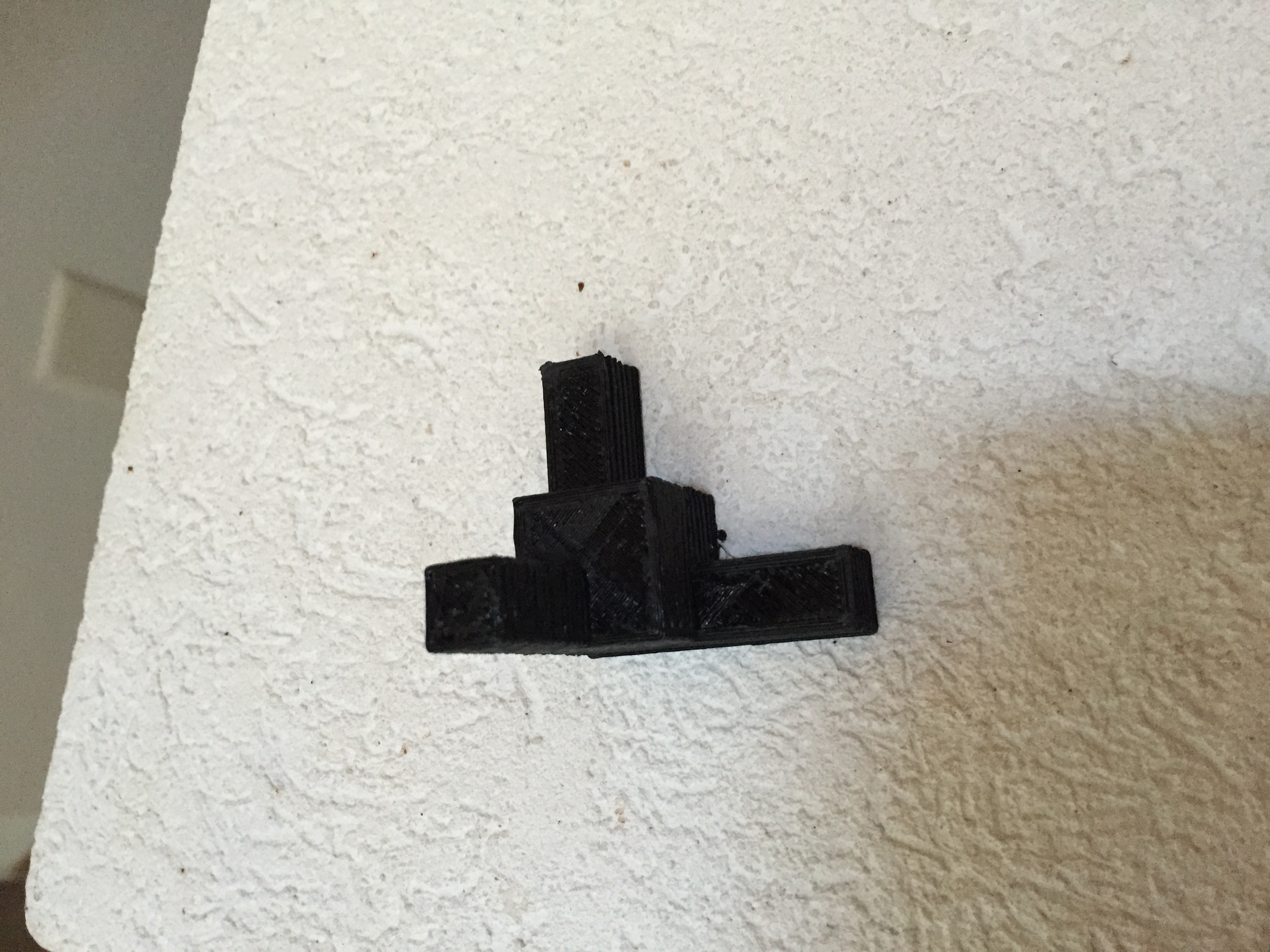

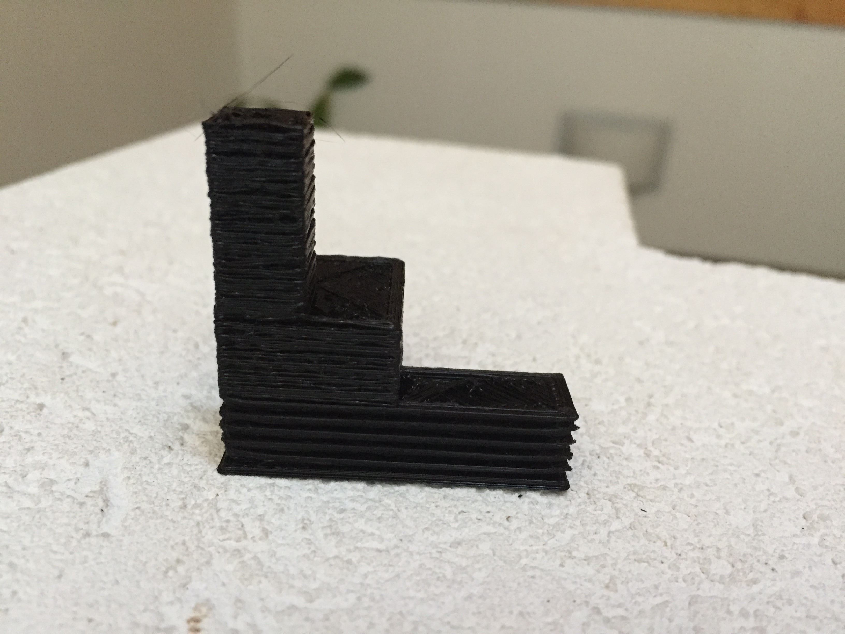

Hi guys,
I am still "fighting" with my settings.
Here is a calibation object that I am trying to print with a new filament but the layer are not aligned.
Anyone know what do have I change to have nice and soft layers ?
Thanks in advance
Syd
CalibrationObject.factory
(2.52 KiB) Downloaded 301 times
Re: First Layer "holes"
