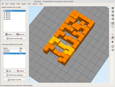

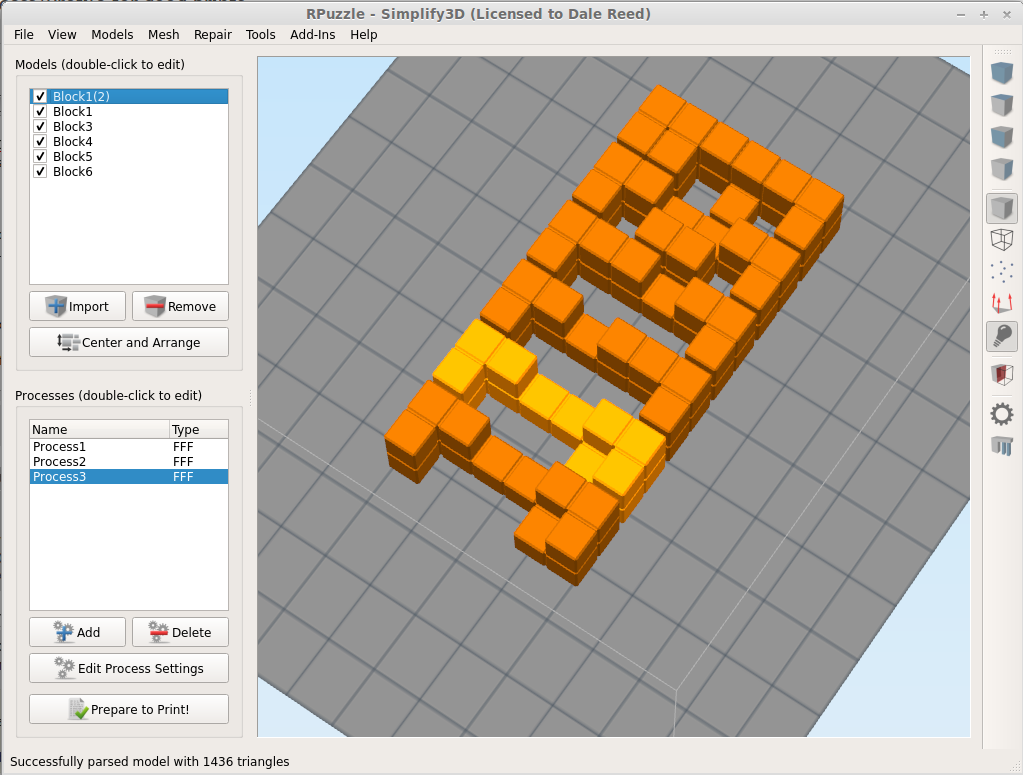

Here's an S3D "job" (.factory) with 6 objects (puzzle blocks):

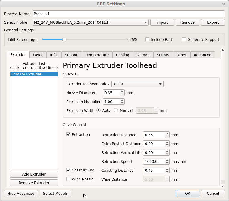

Note there are 6 STLs imports. I've added 3 processes. Now, I want to use Process1 on Block1 and Block1(2). I open up the FFF for Process1:

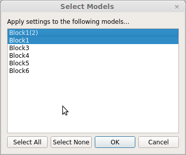

At the bottom, I click "Select Models" and get the Select Models dialog. There I click the lines to make sure the first two (ONLY) are selected and hit OK.
I do the same for Process2, assigning Block3 and Block4 to it, and likewise for Process3, assigning Block5 and Block6 to that one.
This should get you what you want. IT IS ABSOLUTELY VITAL that you understand that just importing an STL, adding a process, importing an STL, adding a process, importing an STL and adding a process will NOT get you Process1 assigned to model 1, Process2 assigned to model 2, etc. In fact, you'll end up with ALL 3 PROCESSES assigned to ALL 3 MODELS. In previous versions of S3D, this actually resulted in printing layer 1 three times (at the same Z height). I know this from having to clean up the mess it made of the nozzle and bed on my M2.
