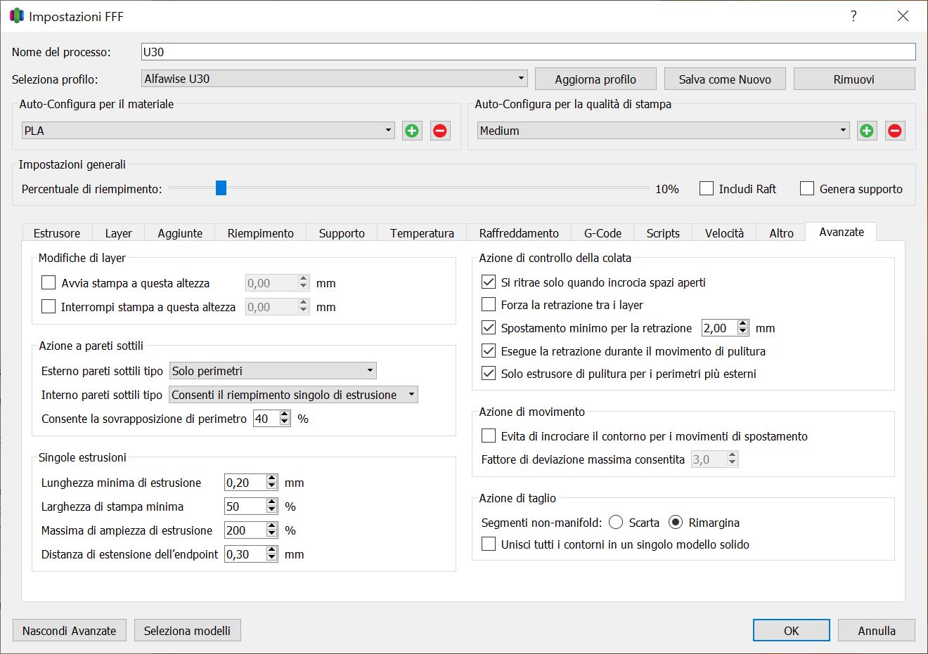

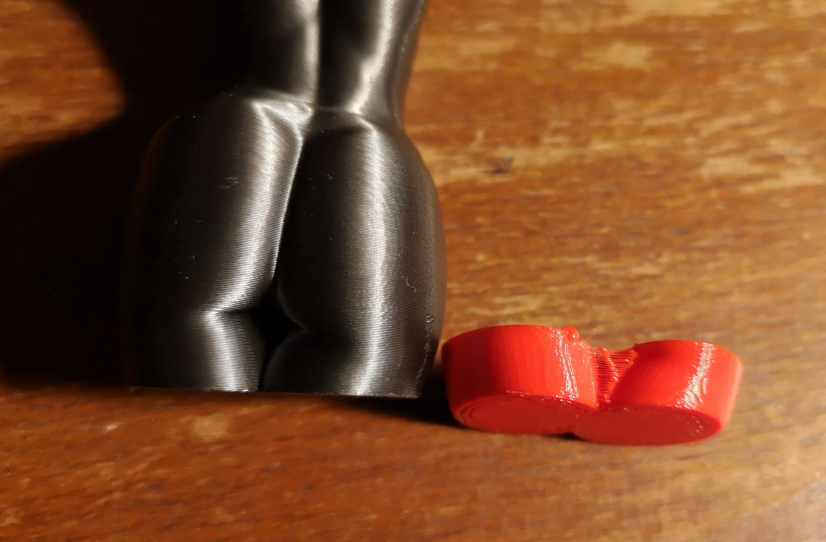

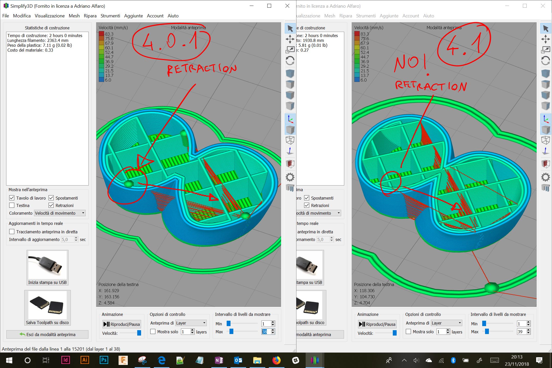

This is my experience...
adrianoalfaro
Joined: Fri Nov 23, 2018 2:25 pm
Re: V 4.1 Retraction at layer change and outline crossing
Hello,
I have the same issue. I can't wait for the 4.1.1 update.
