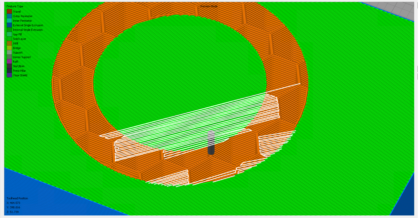

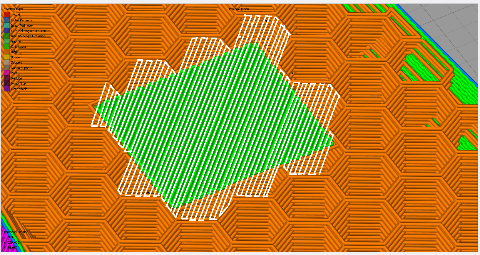

I use simplify to handle a large format printer at work (1000mmx1000mmx500mm).
A common issue i have is that if i try to set the infill low (5%) when it tries to do a pocket or top feature it will end up printing away from any infill causing the feature to fail or not form properly.
And even when i set it higher (30%) it will still have issues near the edge of the feature. even after 5 layers of top fill.
My idea is to make it so that when simplify plans out the first layer of a top fill it plans to continue the edges out to the next support structure. After the first layer it will do any additional layers normally. But giving the first layer an anchor point at each end would help make sure it forms properly.
Attached are some pictures of what i think these first layers would look like.

tookys wrote: ↑Thu Oct 24, 2019 8:46 am I use simplify to handle a large format printer at work (1000mmx1000mmx500mm).
I moved this here as its very similar. Thanks for the screenshots. I think it is great to have another way to look at this problem.
