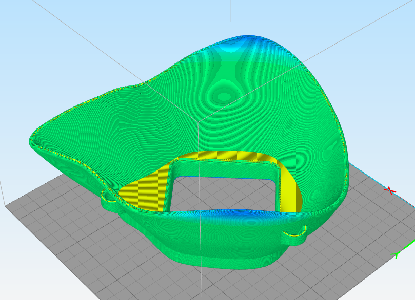

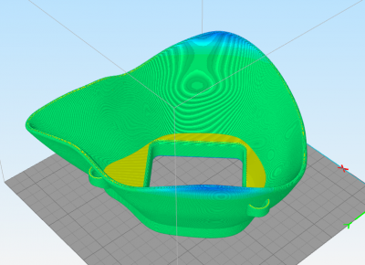

RadRuss wrote:
I can at least comment on my experience - it does seem too aggressive. The print that led to me creating this post was one of many I had done recently, and I see it happen on models where it seems unnecessary. I checked out that thread you linked, and while I can see its usefulness in situations such as that one, it seems like a less common use case.
I personally never had any complaints before this feature was introduced, but I also don't think I would have needed it too often. I do appreciate you responding to the thread!
Thank you for your input but it is difficult for me to tell how the feature is really working here with just this image to go off. Radruss, would you mind posting a Factory File for this?

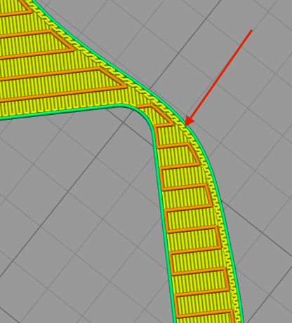

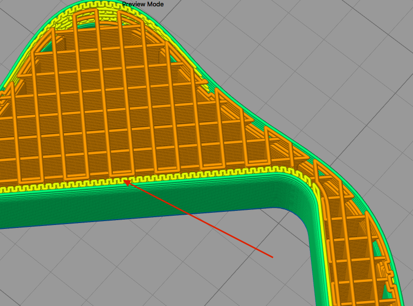

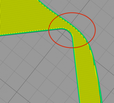

Well, I have this same question, but I think I have better pictures. Here is the entire part:
The first layer is fine, the second layer has the weird infil at the perimeter (in organge)

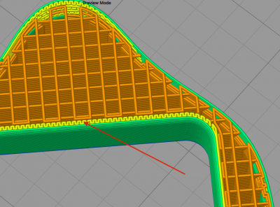

But layer 3 is fine

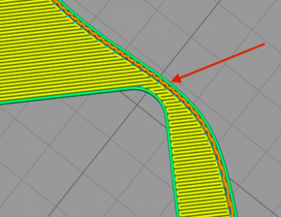

Continuing....

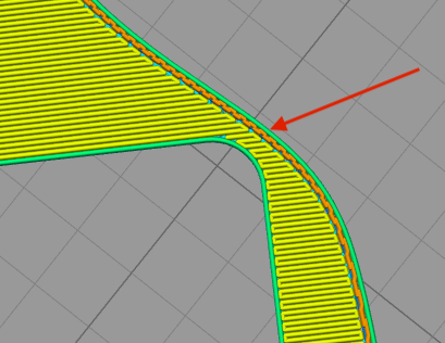

On the fourth layer the strange layer infill near perimeter is seen again when the 20% infil starts

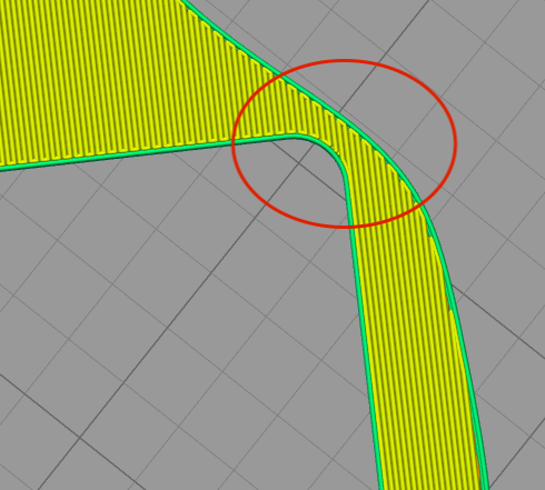

but its gone at the 5th layer

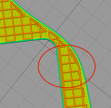

Then it doesnt show up again until just before the first top layer. Where the arrow is pointing but also at the top of the image in yellow
I dont see a way to make it go away, its not needed for any of this. I tried 1, 2 and three perimeter layers. I tried a number of different setting and infils
